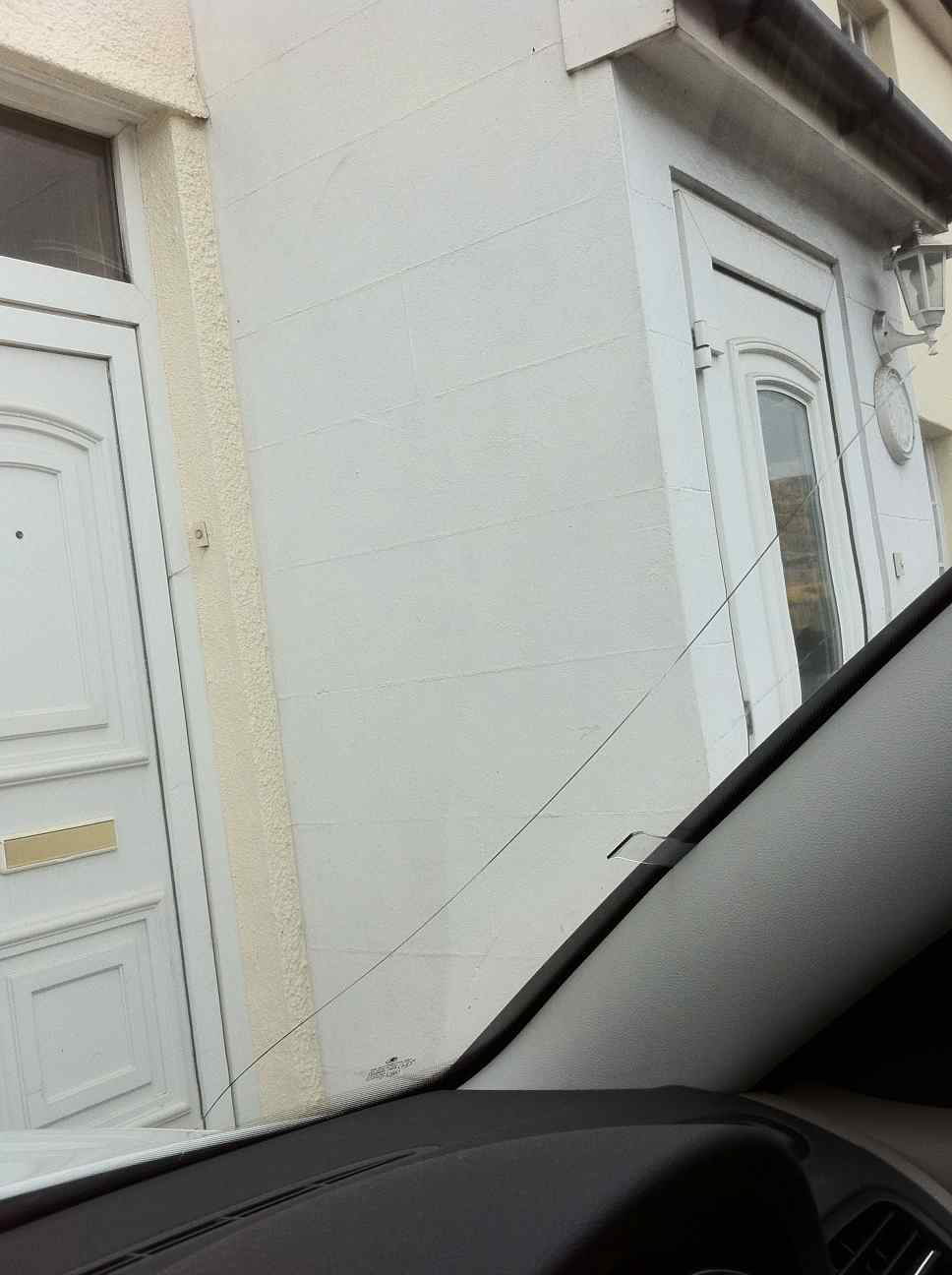

Whilst taking part in the wacky races on the M42 round Birmingham last Friday afternoon, the van in the outside lane pulled off a sneaky trick of firing a large stone straight at my windscreen. :'(
It hit with such a loud crack that I actually ducked! The impact was just above the wiper, not quite in the middle, slightly over to the passenger side. Within a couple of miles a crack had spread upwards all the way to the top, so I now have a 'split screen' Yeti.
Whilst its not particularly distracting, being over on the passenger side of the screen, I will obviously need to get it replaced.
Taking a quick look, the edges of the windscreen disappear under the black plastic trims on the A-pillars, so I presume they will need removing as well as the plastic scuttle at the bottom.
Does anyone know how these trims remove - with there not being that may Yetis about yet, theres a reasonable chance whoever turns up to replace it, that they may not know how they are attached and I don't want them breaking anything else.
Also mine has the sensors for the wipers and headlights up the top of the windscreen. Is this attached to the interior mirror and just pressed to the glass or is that another load of fun and games?
