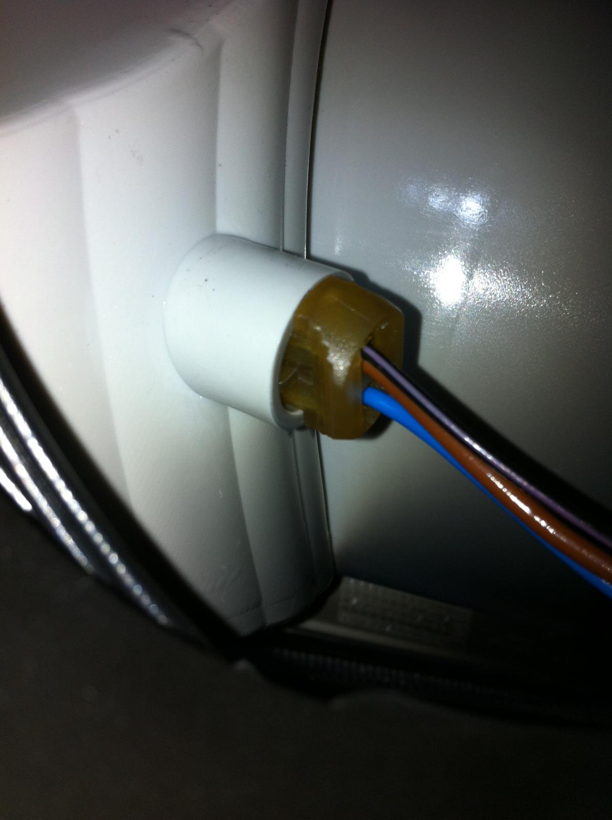

Could someone please help me with how to actually remove the small sidelight bulb-holder from its location in the plastic headlamp unit moulding?
Thanks.
John C.
Hi JohnSea,  looking in the handbook (2013) it states the fixture (holder) just pulls out.
I presume you have removed the round cover at the back of the light housing?
Hi Thingy,
Yes, I have removed the cover, hence the photo, but it's a tight space, and whilst I have tried just pulling it out, I had no success.  However, I did not want to pull too hard in case I was missing something?  So, it's just a straight pull, is it?
Thanks.
JC
If I remember rightly there are 2 sprung bits of metal either side holding it in, and you need to pull quite firmly.
Llanigraham,
OK, thanks, I'll try again...
John C.
