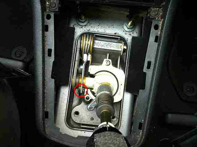

Can anyone sugest where the spring might be in the o2j that centres the gear lever?
The large spring on the left is the left-right pressure spring. If you look at the area circled you can see the limits for that centre position are set by the part between the spring ends. My guess is the underside of this part is worn pushing the ball arm up and the position to the right.
The spring shape also affects the left-right centre position
