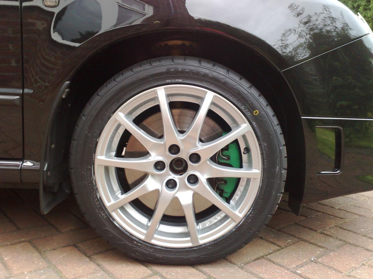

For the hub question - no that will remain at 57.1mm. So if you're upgrading to the 312mm brake setup, you can still use your 16s. The brake setup looks good under a 16" wheel too as it fills most of the inside of the wheel :thumbup:
Here's how they look behind a 16" wheel. That's a Seat Sport Speedline there from one of my Fabias.
