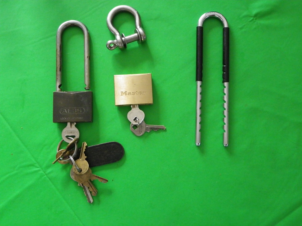

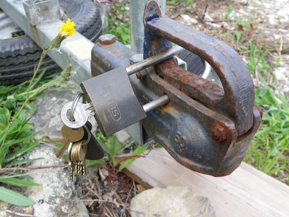

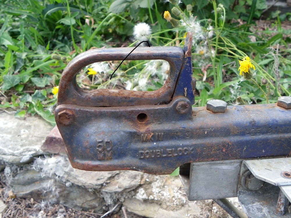

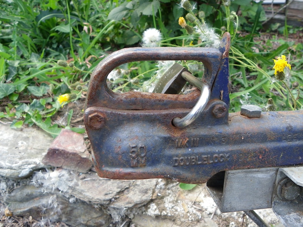

Ok some pics of the various items, plus view on securing on a non lockable Bradley hitch!

Thanks guys. I will have to put my thinking cap on as to how to get it connected to the trailer and still be able to use my security hitch lock since the old connection for such a cable has been removed to make the hitch lock work! Doh.
