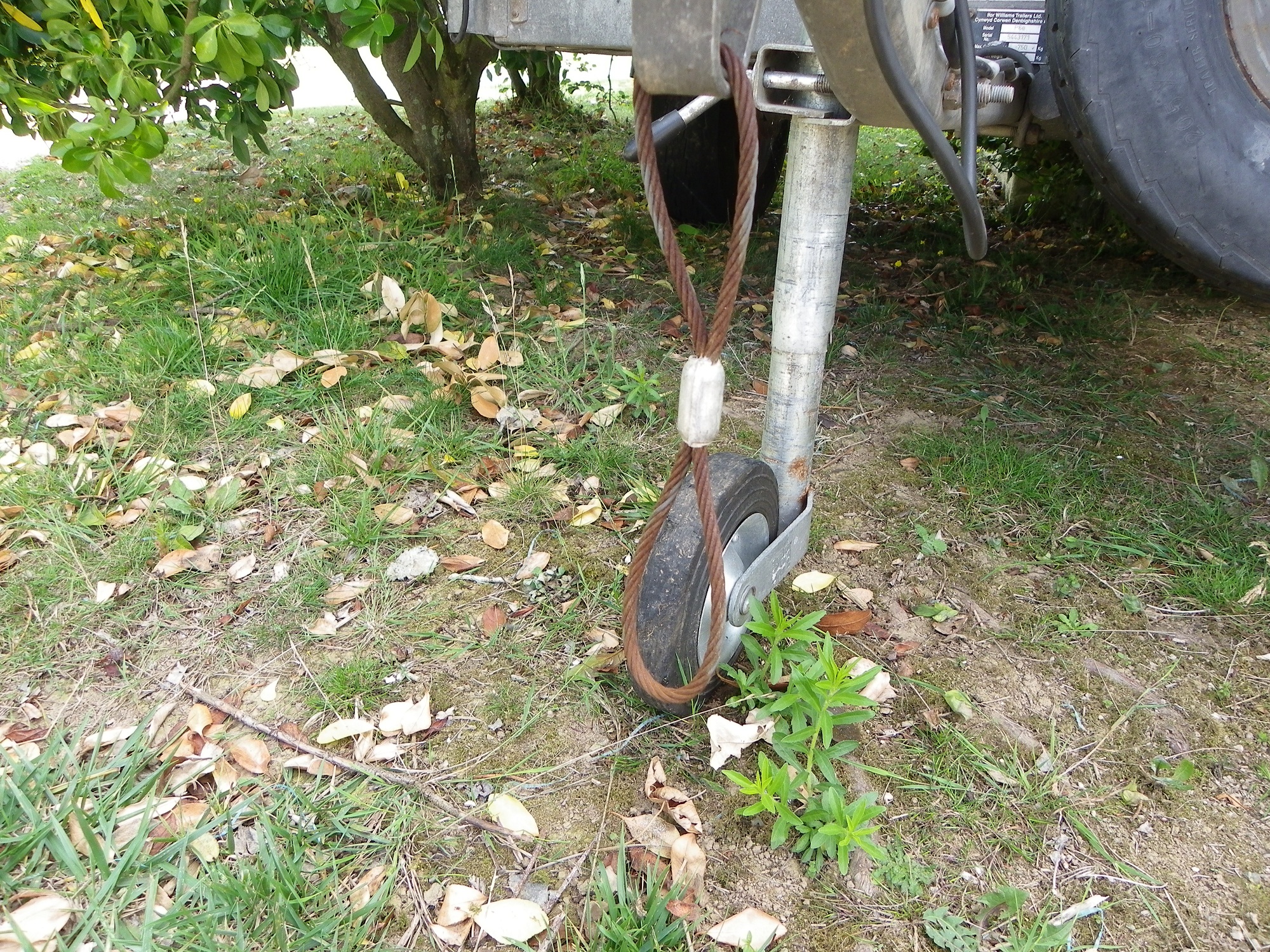

I am assured by my local(when UK based)Ifor Williams depot that their breakaway cable, a figure 8 in 10mm cable about 350 - 400mm oal length when permanently attached to the trailer with a robust mounting and just hooked over the towball adheres to legal requirements, it is designed for an unbraked trailer of 750kg but the breaking strain is of the order of 1500kg!
Photos if required can br mounted

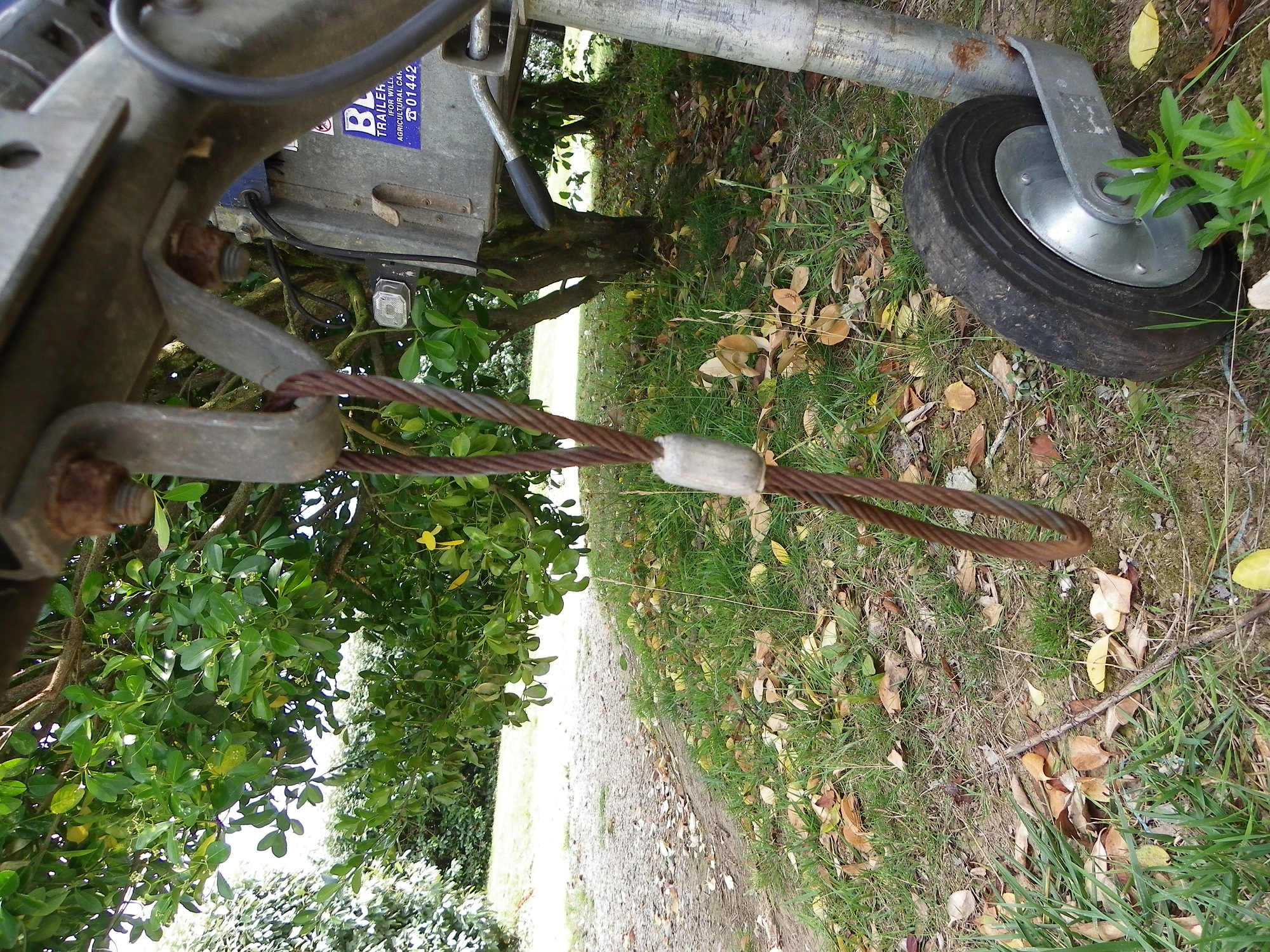

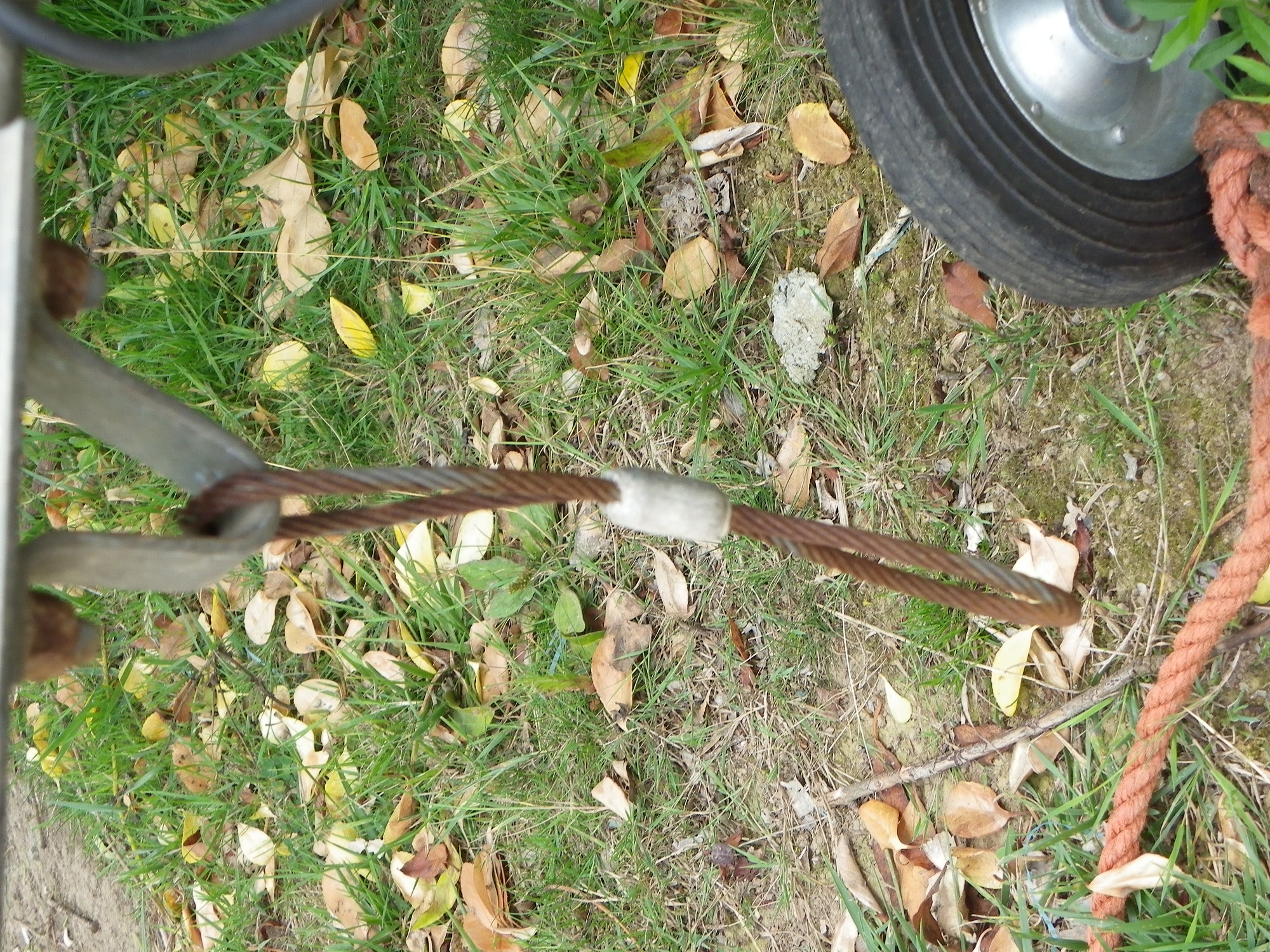

Pics attached, thought I had a part number, cant find it, but if you contact IWT or a local distributor they should know the part as its std kit on an unbraked trailer supplied by them!
Overall length 30 cm
3rd pic
Ah thank you very much Frenchtone... Looks very sturdy....... BUT how does it connect to the little hook Å koda has now attached to the innards of my towbar?! Shown here in post #46.
Don't ask me - I don't know, I just hook mine over the swan neck!!
Butch D shackle in stainless? - normally a boating/yachting bit!
With your arrangement the loop might not be long enough! - hence the swan neck solution.
