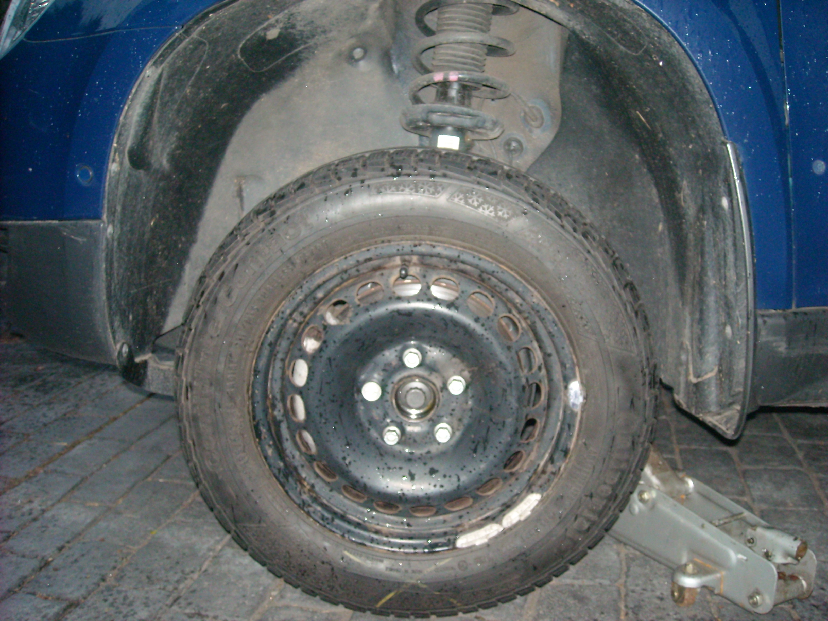

I have been out in the rain swapping tyres, well front only, as it has the larger brakes.
The 15" rims FIT !
They are close to the brake caliper, but the wheel rotates by hand without any problems.
I am trying to add pictures to prove it.
The 15" rims FIT !

Sorry to be a gloomy poster on this thread but I would be very cautious about this sizing -3cm is more than an inch less than standard and this sounds quite a lot. Are you sure that the tyres are up to the required spec re loading and speed rating? They may be cheaper but that size would generally be intended for smaller and lighter cars than a Yeti. Specification is as important as physical size :rofl:
The picture shows them to be almost lost in the wheelarches and the centre hole looks to be larger than the centre of the hub - spigot. It could just be the angle of the photo but you can fix this with appropriately sized spigot rings if needed. If there is a gap, the weight of the car is placed on the wheel studs.
The tyre /wheel combination would appear more appropriate on a Fabia or Roomster but they take 5x100 pcd, so no use there.
I placed the tyre on top of the 17" Yeti tyre, same external diameter.
With regards to the central hole, it fits exactly over the hub spigot section.
