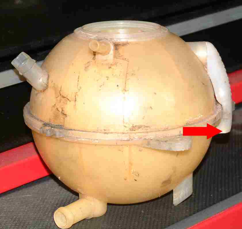

sounds like roughly where the coolant header tank is, you may have the same issue as me then!
It's not uncommon for the pressure caps on the coolant reservoir to leak
When it does, the water/steam comes from the tube marked with an arrow so it is not always obvious.
