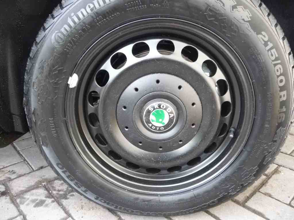

I bought some of these Skoda badges off eBay. They are intended to click in to the centre holes in alloy wheels so they have plastic tabs on the back. I used pliers to twist the tabs off and trimmed off the stubs with a Stanley knife. I then used a fretsaw to cut the large VW logo out of the middle of the wheel centre cap (the logo is domed so it makes the Skoda badge sit too proud). I used Evo-Stik Serious Glue to glue the Skoda badge over the resulting hole. The bits that fit over the wheel studs have a Volkswagen logo on them as well so I've ended up with a mutant VW/Skoda centre cap, but the Skoda bit is definitely more prominent.
I'll try to post up some pictures of the process and the finished product at some point.
