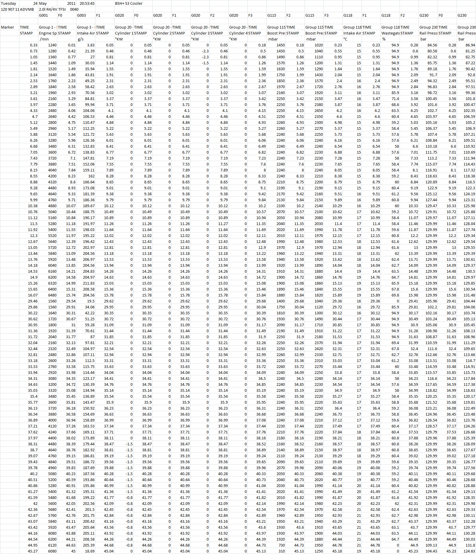

I'll have a look at my logs later but before cooler and intake I had no boost drop after the spike had finished, just a nice smooth rise. I also had no timing pull until it started to heatsoak.
Looking at the graphs more closely it appears where I have the drop in torque @ 3700rpm the AFR leans out more than the rest of the AFR. So I believe this is a little fuel cut due to the spike using a lot of the fuel the pump is providing, The pump takes a while to catch up again.
An Rs4 FPR may fix this.
Did some logs tonight if anyones interested. Two consecutive runs, I don't really see any problems on the road.
