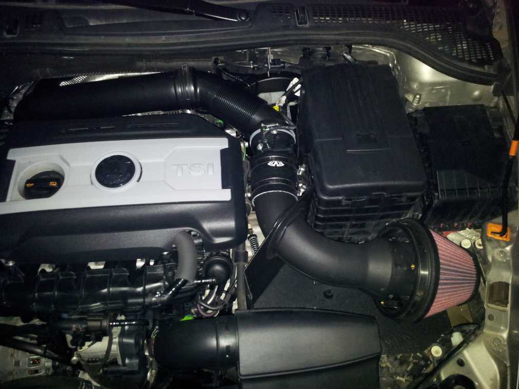

1. S3 Intercooler
2. EVOMS TSi Intake

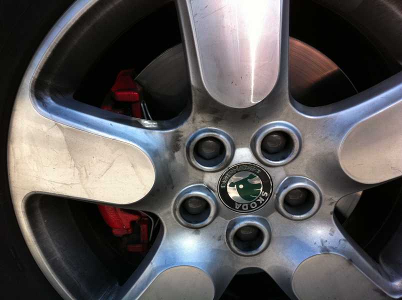

4. 312mm breakes

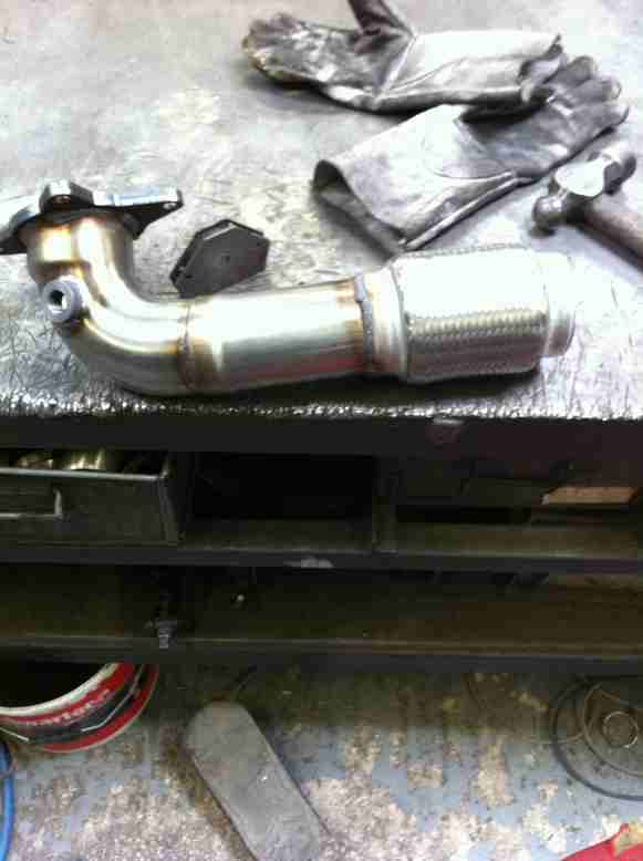

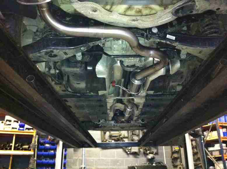

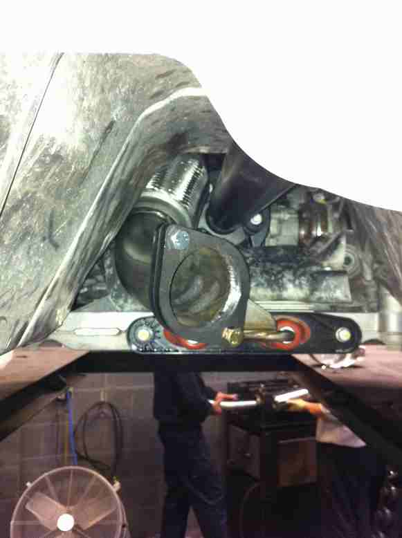

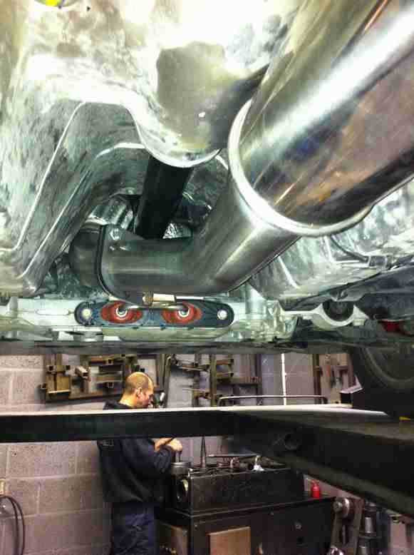

Lost a few days about the decat/sport exhaust as no one in UK had one or done one, so finally Jeff from Pipewerx made me a custom one 3" downpipe to the silencer, then 2.5" all the way to the end. I went to his shop all day 11am-8pm :) and he did a great job. Top guy!

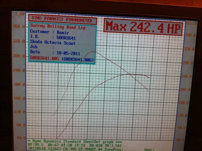

Rolling road was done by Charlie at Surrey Rolling Road as it has a 4wd Dyno. Top guy too.

Dyno says 242.4HP sand 300 Lb/ft on RON95 as that's the way how the map was setup, since petrol here is 95 max.

EVOMS intake is not too obtrusive, can be heard on hard accel. and takeoff, but not that whoooosh sound that i hate.

Breakes (VRS OEM) are superb, feel much better then normal ones.

Nice work matey, very impressive torque figure that. :thumbup:
A Scout with 242bhp,I bet that will surprise a few people! :thumbup:
Especially with 4wd. :o
I don't know a lot about this engine but good peak torque figures there :thumbup:

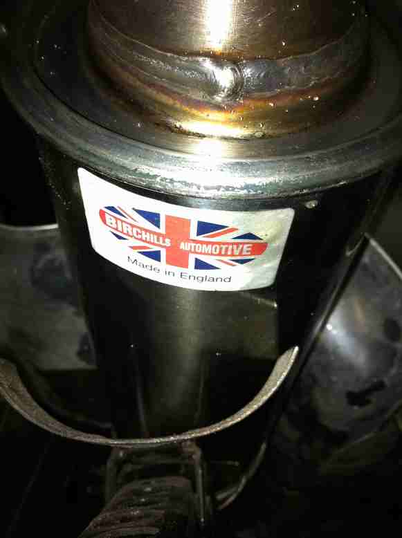

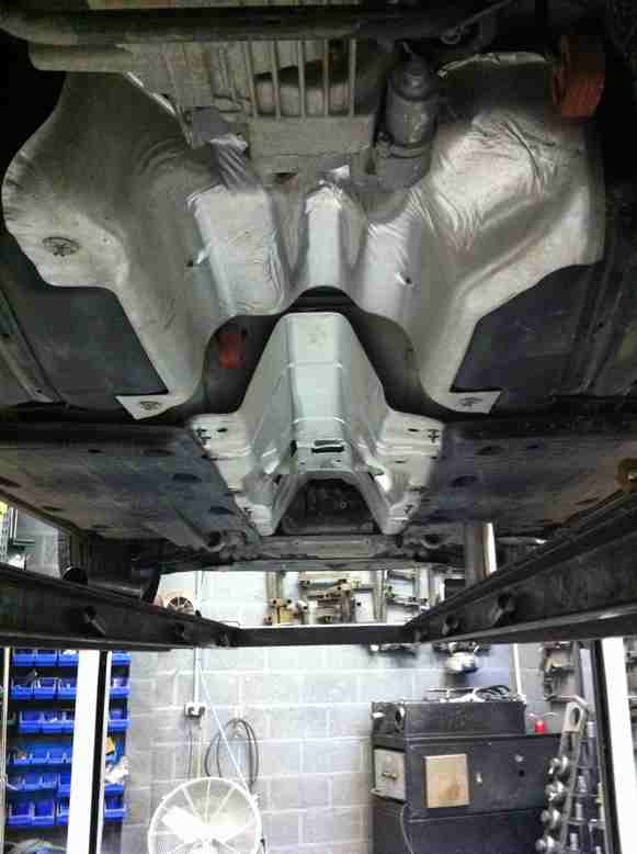

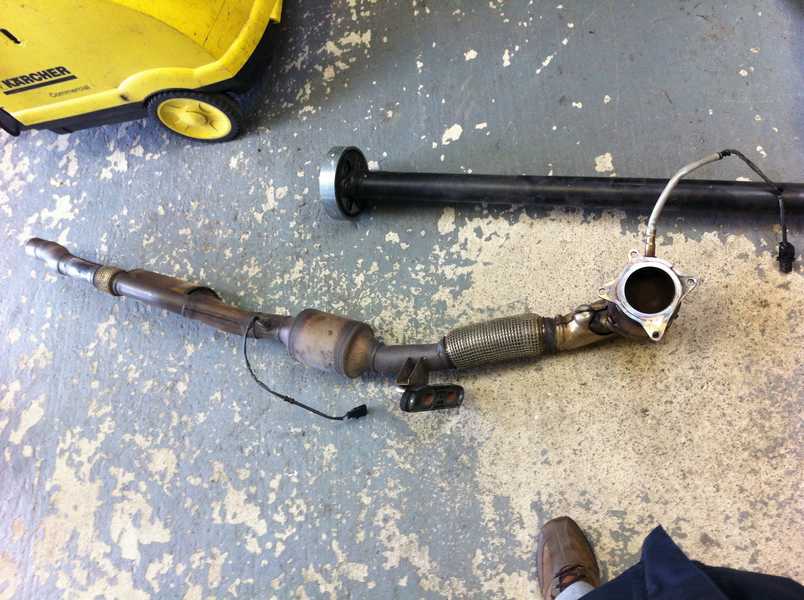

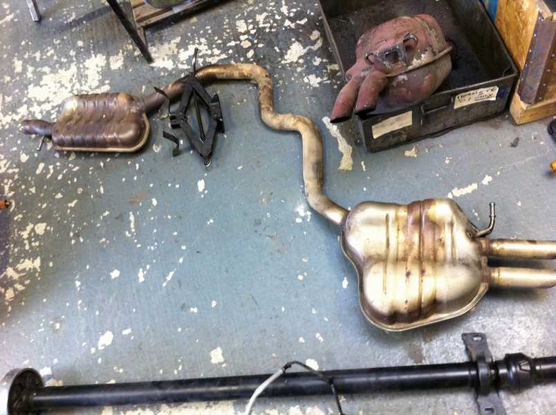

725. Pain was to make it with prop shaft taking quite a bit of space, and oem exhaust was stupidly squashed in a few places to make space.
Here are some pics of exhaust and last 2 oem exhaust.
