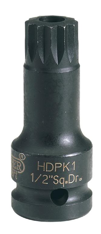

Needs splined tool (picture) to remove drain-plug and filler/ level plug. (picture)

^^^^^^^ looks right....I used Millers motorsport oil.........drain the oil hot...do it on a warm day after you have been for a drive....then leave it draining for 1hr to get all the crap out...leave car on level surface.......I redo mine every 5 to 6 years....much better....remember to do the drain and filler plugs back up to 25Nm (18lb ft). B)
Good tip is make sure you can remove filler plug before drain plug!

There should be two torx (anti-tamper style) plugs one at the very bottom the other higher up on the oposite side of the gearbox to the drain plug!.
