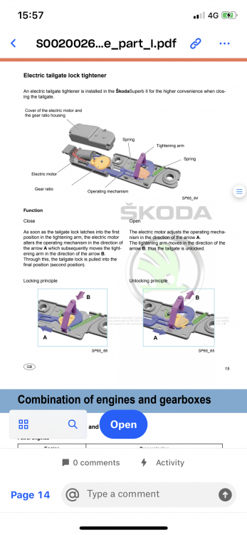

Did you resolve this? Same thing is happening to my Superb Estate. From your diagram, it would appear that the tension spring is missing in mine, but haven't found a broken one in the boot.

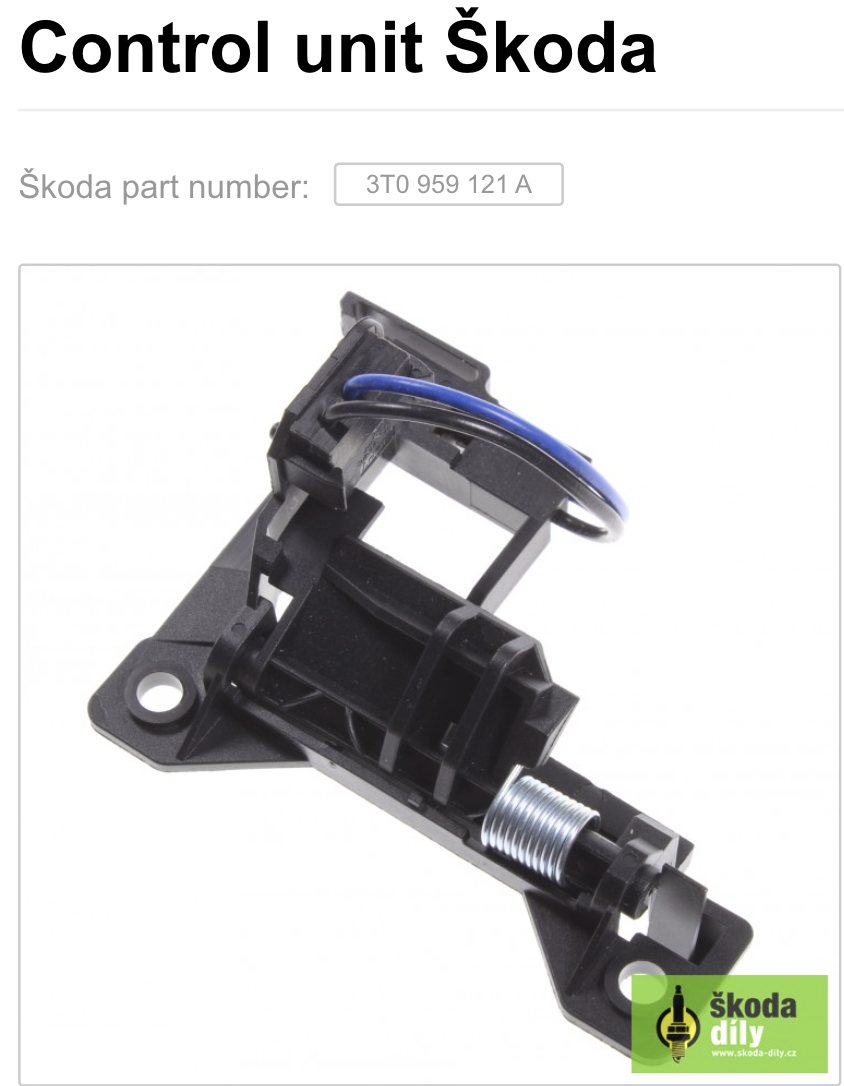

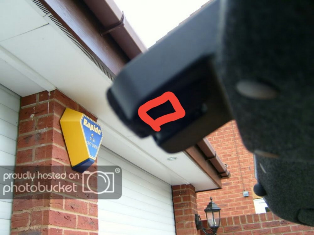

  • Similar issue with the larger hatch glass panel not opening. Have applied Greenliner1's approach with pasting a soft tab, it worked and connected with the switch to give the 'all door locked' brake fl
Similar issue with the larger hatch glass panel not opening. Have applied Greenliner1's approach with pasting a soft tab, it worked and connected with the switch to give the 'all door locked' brake flash. I want a more permanent solution so would replacing this control unit <https://www.skoda-parts.com/spare-part/3t0959121a-control-unit-skoda-41252.html> be the way to go?
The aforementioned microswitch clicked in mine but the black plastic spring tab seemed to be a bit farther than i like, is there an adjustment tolerance there to make before a replacement unit is made?
