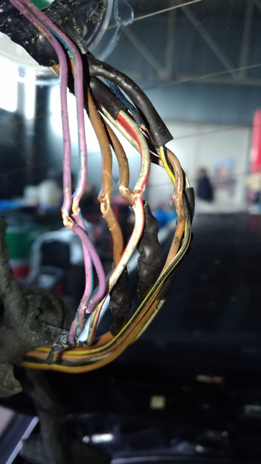

Lads, it is the wires that run on the left side of the boot that usually give trouble. They break between the boot lid/window hinge area. Remove all the boot trim on the left side, fix the wires, put the trim back and never open the boot in saloon mode again. Only open it in hatchback mode and you'll never again have trouble from it. I did mine 2 years ago and it still works fine.
Yes, but I like this options and always use small boot. I now that probably it will happen again :)
BTW
I had a compilation of electrical faults that were responsible for not working soft closing :
- broken wires in hinge
- broken micro switch (this with flap, on the bottom
- broken one of two micro switches in boot lock (this was the most difficult because second switch was working and I received information about lick position. This was very misleading. )
Do a VDCS test to confirm the circuits and switches. Then remove the left side plastic cover and inspect the wiring. It might look like mine stretched  in with compromised isolation.
Try to repair the damaged wires with good quality ones as the OEM bundle is not an reliable option due to the short length problem generated by the manufacturer.

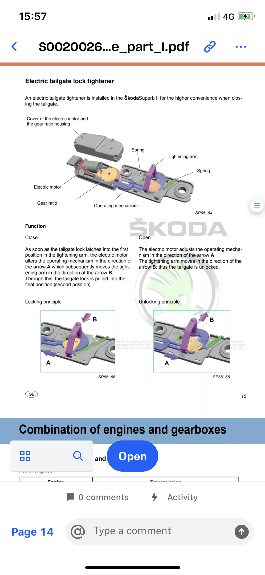

Skoda superb hatchback 2015,  opens the boot’s door/lid  after 5 seconds by itself. When I push the latch with screwdriver on the boot’s door the operating mechanism moves to the right and pulling the Tightening arm down, so the boot now locked. Just after 5 seconds that operating mechanism moves back to the left by itself and opens the boot’s door.
When I close the boot and go sit in the car, it opens by itself so I need to drive with open boot, the boot is not coming up but it’s loose and makes noise while I’m driving.
Could anybody help. Thanks
