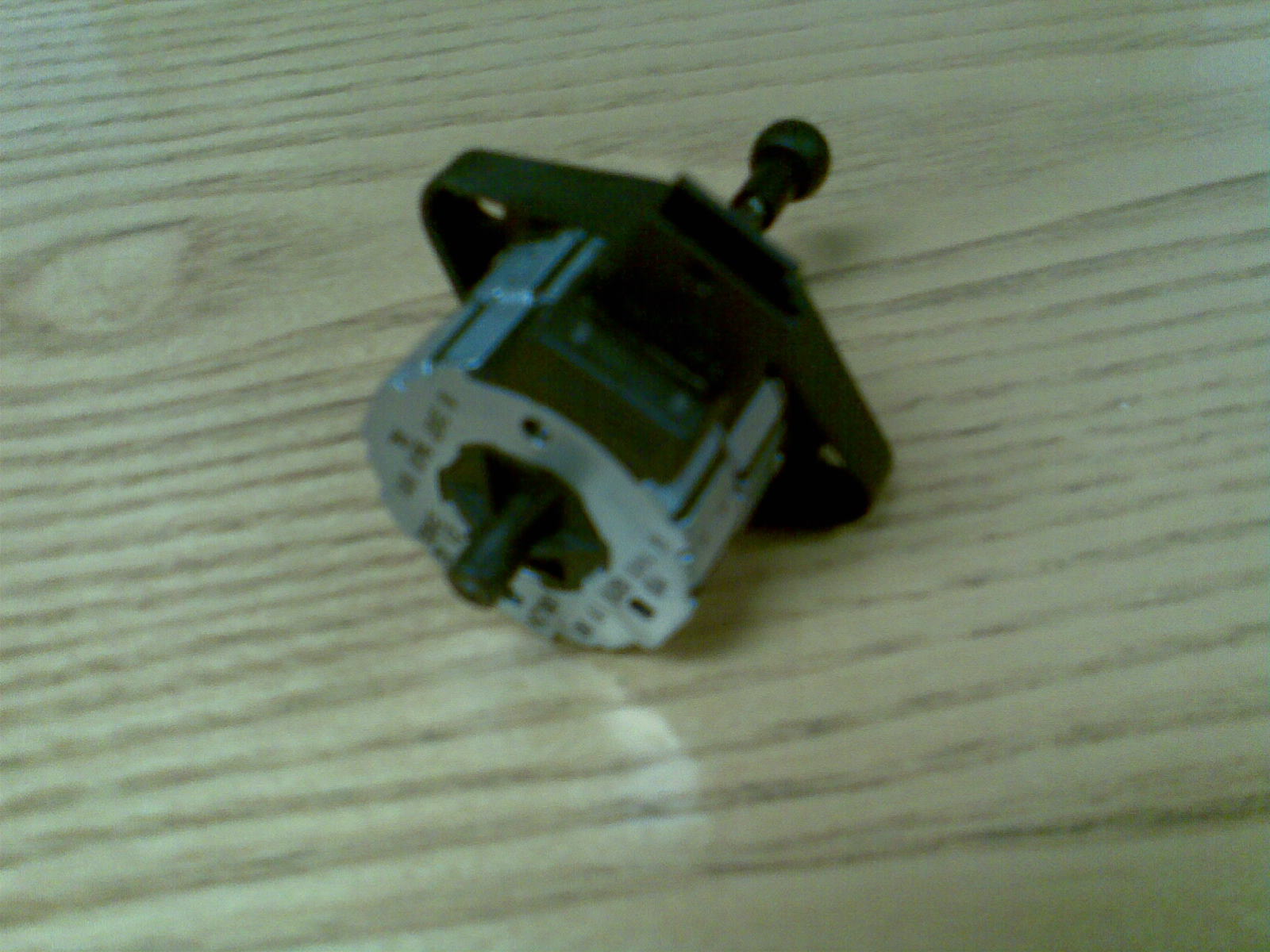

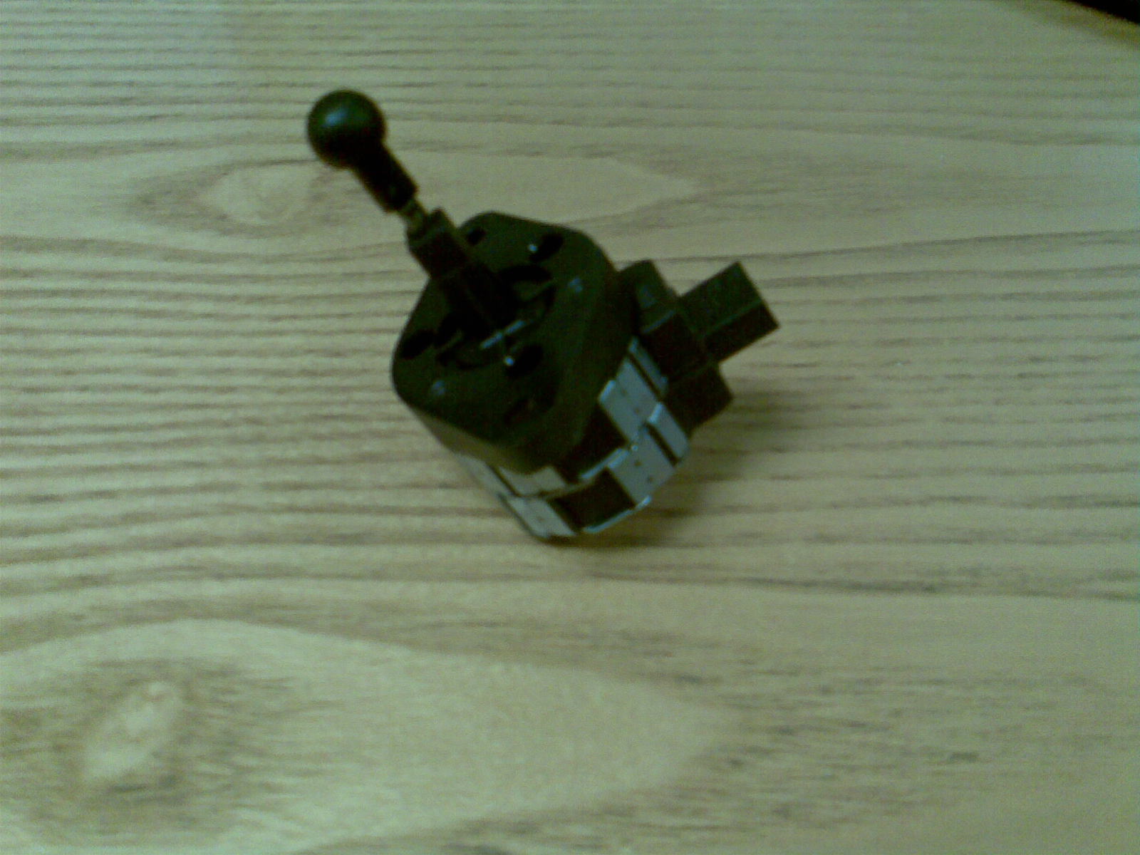

This is the motor:-
Is there a motor in each unit?
yes. each h/l works independently but uses the same level sensors. (one front, one back.)
Part number is 1U0 941 295B.
