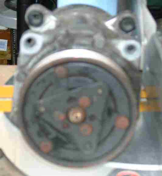

Inside the a/c compressor pulley, there is a clutch plate. When you switch on the a/c does the centre nut start to turn?
If not, it could be a simple wiring problem.

I found part of the a/c pump sheared off and lying on the drive, so think that is pretty terminal.
Only reason I asked about scrapping is that I wasn't sure if the car had enough value to warrant further repairs prior to sale.

If what you found looks like the plate in the centre of the pulley (see picture) then it is the clutch plate. Look at the end of compressor spindle. Does it have any thread left? If it does, you can bolt the clutch plate back on.
Probably needs a new pump, the clutch plate coming off normally is the end of if....
