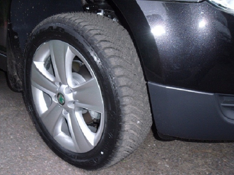

Hello Pete and welcome´.
I have been very happy with my set-up, which you can see below.
My personal reasoning for the alloys in winter is that they are machined and perfectly round - which stamped steel wheels are not. The winters have seen two long trips down to Costa del Sol and back and have performed well in all conditions from rather deep snow to high speed at summer temperatures. The winter tyres were selected for the best possible wet performance, as that is where you are most likely to experience a need for the ultimate grip. they do have a slightly higher slip angle than the summer tyres, but that is only noticeable in high speed dry cornering.
I run the summer tyres at 2.3 bar all around for normal load situations and the winters at 2.4 bar. It seems to provide an even wear pattern both front and back, rotated front to back at each change from winter/summer.
The sumer tyres absolutely stunk at straight line braking on simulated winter conditions on a skid pad - but were OK as long as there was an angle component involved, such as in cornering.
I have not experienced any of the pitching/harsh ride with the 16" set-up that some with the 172 50-series have complained about.
