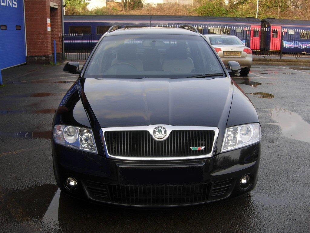

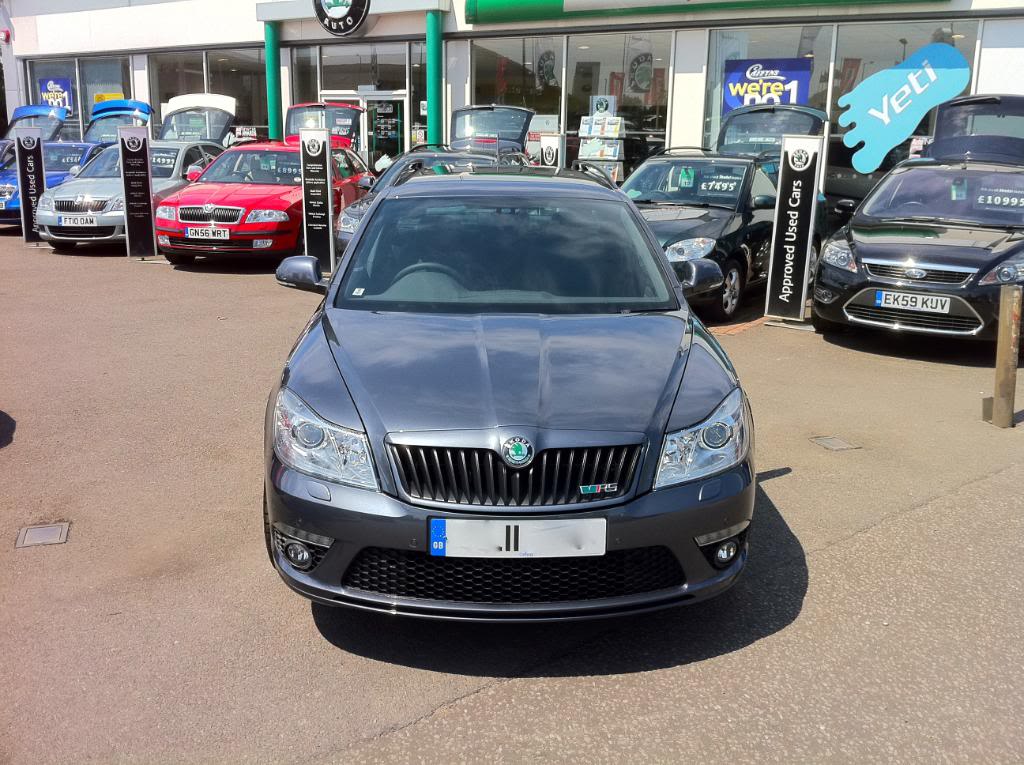

Although, comparing the pre FL and FL front ends, while the grille may physically fit, due to the curvature of the FL grille at the bottom wouldn't you need to change the bumper and with it both wings and headlights??

The bonnet is the same part no. regardless of year. However the curve you have highlighted will probably require a bit of alteration to the front bumper if putting an FL Grille on a Pre-FL Car.
Going the other way will leave a gap below the bottom of the grill as, having just looked at mine the front bumper is stepped to take into account the curve.
Just done a bit more research and part no. 40 is added on to a FL Bonnet to take into account the curve. Just had a look at mine and it is riveted and screwed to the bottom lip of the bonnet.

Like i said above you will prob have to alter the bumper to accommodate. But without physically looking I'm not sure to what extent.

The good news is you could fit a pre FL on an FL no bother.

The lower arc of the grille is different. The FL grille does fit on the pre-FL although it looks ****ty. The other way round might look better, never seen it tho...
You can see 4 yourself here: http://www.octavia-forum.de/forum/viewtopic.php?p=506920#p506920 - looks terrible. The other way round might be problematic because you can see a huge gap in the front bumber...
