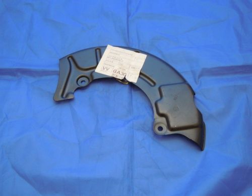

Front NS Brake Disc Cover Plate
Front NS Brake Disc Cover Plate KEEPS ON VIBRATING on disc .
can i revove it aLL TOGETHER
or should i just replace it with a new one :'( :'(
You don't need dust shields. If you take them off, you do sometimes get more water on the discs. Just take off both of them rather than only one.
Although that photo looks like you've only got half the shield there? They normally cover more or less everything the caliper doesn't if you have them.
PIC WAS JUST TO GIVE PEOPLE SOME IDEA WHAT I WAS ON ABOUT,
IL TAKE THEM BOTH OFF , CHEERS :thumbup: :thumbup:
