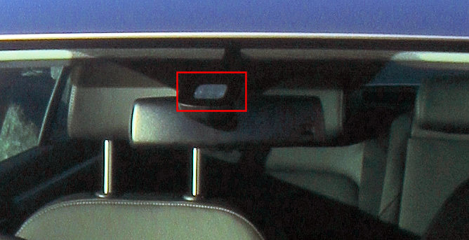

Where, exactly, IS the sensor and what is the best way to clean it?
Is it on the back side of the central mirror, many cars have them there ?
In fact you can see two sensors - I guess one for wipers one for lights.
Edited by lmb
Perhaps check there is not a bit of plastic film over the sensor that should have been removed at the PDI or grubby finger marks on the sensor ?
