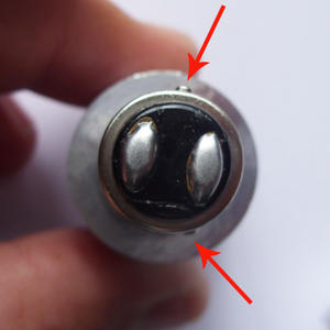

It will be the wrong bulb requires type 566 and not type 380. Different offset pins involved.
Yeah it's common for people to stuff the wrong bulb in. As xman said, the correct bulb is 566 with offset pins.
