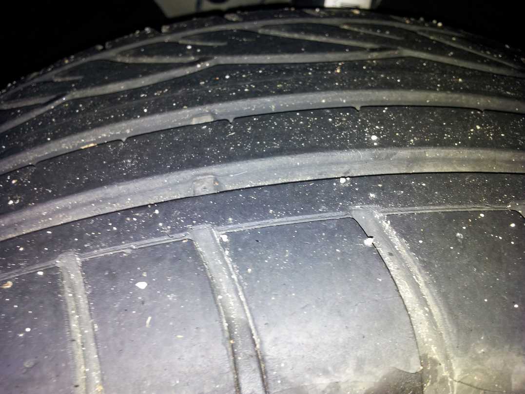

I have Ved Ultrac Sessentas on my vrs petrol 10 reg. I have done 14k. The tyres are not illegal but low but avove the pimiples, now it's wet it is slipping lots in first and sometimes second. Are other VRS drivers finding slipping lots now the roads are so wet or is it time to bite the bullet and replace them?

Yeah, time to change by the sounds of it. Especially with the bad wet, cold weather on the way.
The legal limit is 1.6mm but i'm sure most companys say they should be changed at 3mm. If you have noticed you are struggling for grip you should be changing, the weather isn't getting any better. Maybe get winter wheels/tyres and just buy new summers next year, ideal if you need tyres anyway.
Below 3mm is when the SIPPS (worth googling about them) which are apparently key for water dispersion. Personally I am too tight and not having SIPPS isn't going to make the car suddenly lose dramatic tyre performance. I will change once the tyre approaches the legal level.
If it's spinning up enough to activate the traction control and/or ABS regularly, it's time for new tyres.
Changed my fronts at 2-3mm. The understeer was getting a bit too much.
The IAM recommends that tyres are changed when the tread gets below 3mm.

As others have said, 3mm is as low as I go. You should be able to feel the deterioration in grip levels around the 2-3mm mark.

On a more serious note- the police change tyres when half worn, ie about 3.5mm
There is a reason for this
I personally know of 2 people who have aquaplaned on the motorway, and crashed into the central reservation.
In both cases the tyres have been around 2mm, ie still legal.
So I'd change BEFORE the tyres get down to the wear markers, ie at around 2.5mm
Go to Halfords, buy a tyre depth guage for about a fiver, and change the tyres if they're at 2.5mm.
