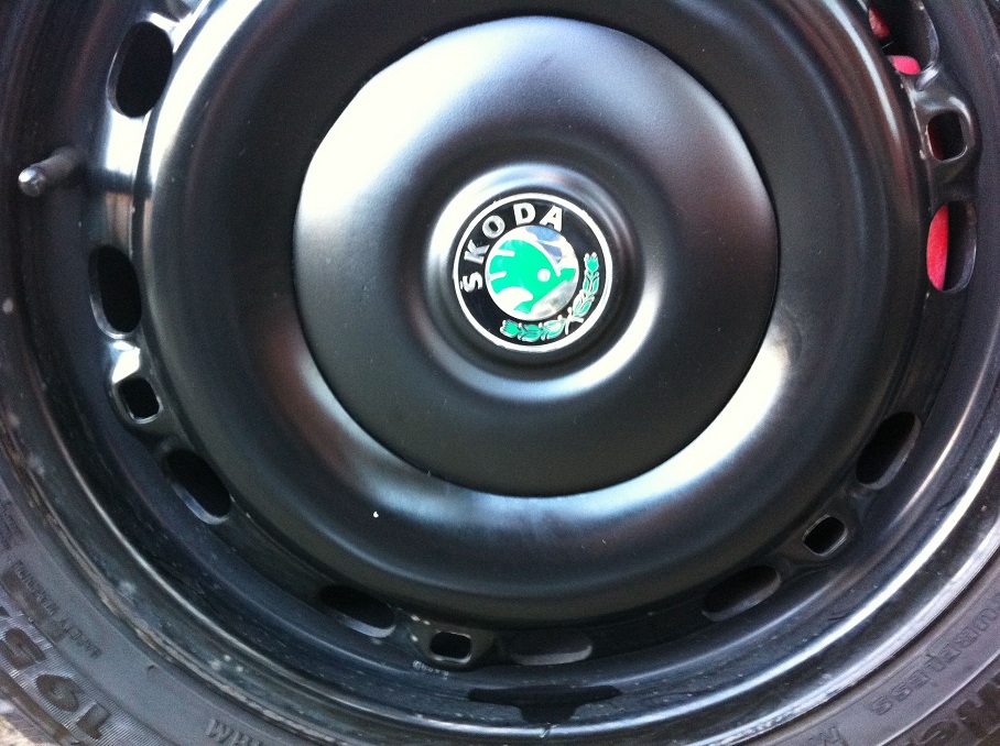

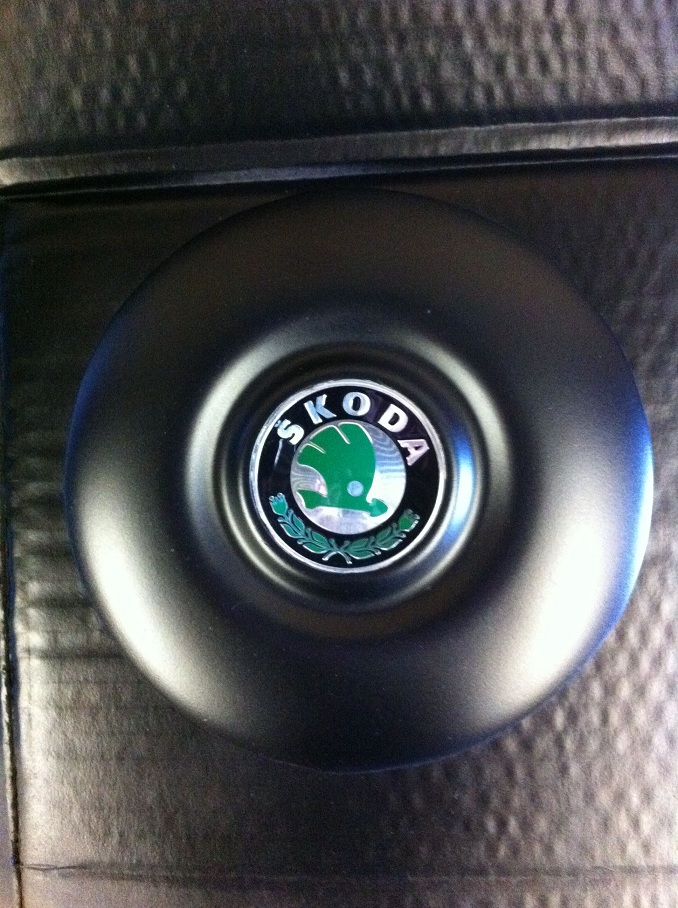

Now I have some time off over Christmas, I decided to give this another go. The guys at SkodaParts.com suggested I cut the outer rim from the caps I bought from them (Part number earlier in this thread).
So I did! I didn't have a jigsaw so cut them using a hacksaw by hand. They are not perfect but look fine I think!
Once done they will push all the way back and clip firmly into place over the wheel nuts. I then got out the spray paint and coloured them matt black.

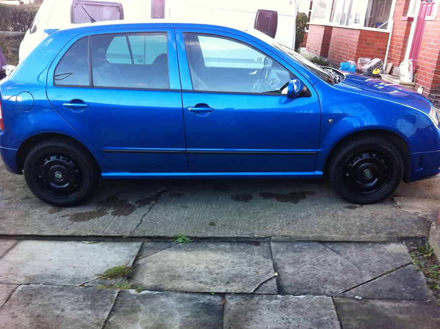

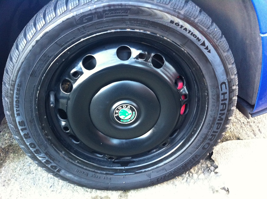

This is what they look like on the car.
The pic above was the worst cut one that I did first. The others are better.
Anyway - an alternative to covering your winter steel wheels! B)

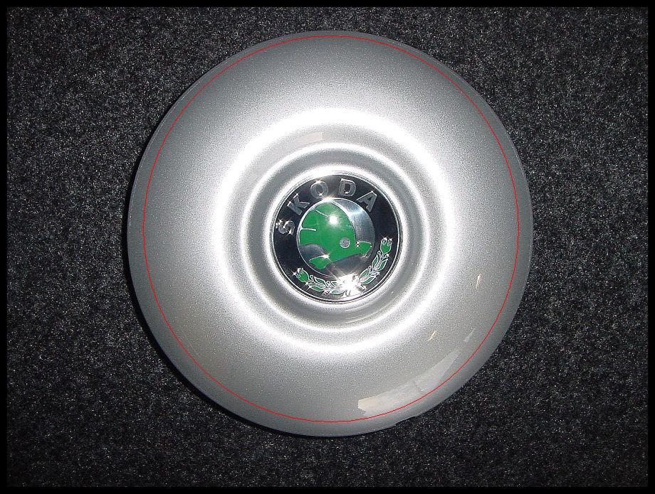

Maybe a picture of the underside of a modified cap would help others to gauge just how much to take of - that could be compared with the pictures you took of the unmodified cover.
Yeah will do when get time. Basically just cut the rim off. You can see it on the underside. A couple of mm.
