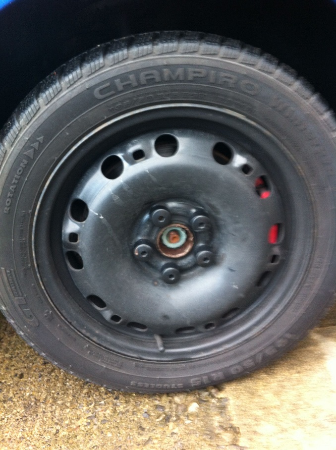

Been reading many threads on here about centre caps and steel wheels. I have a set of VAG 15" 6J steel that I bought with winter tyres from a very good member on here and want to try get some caps to fit them.

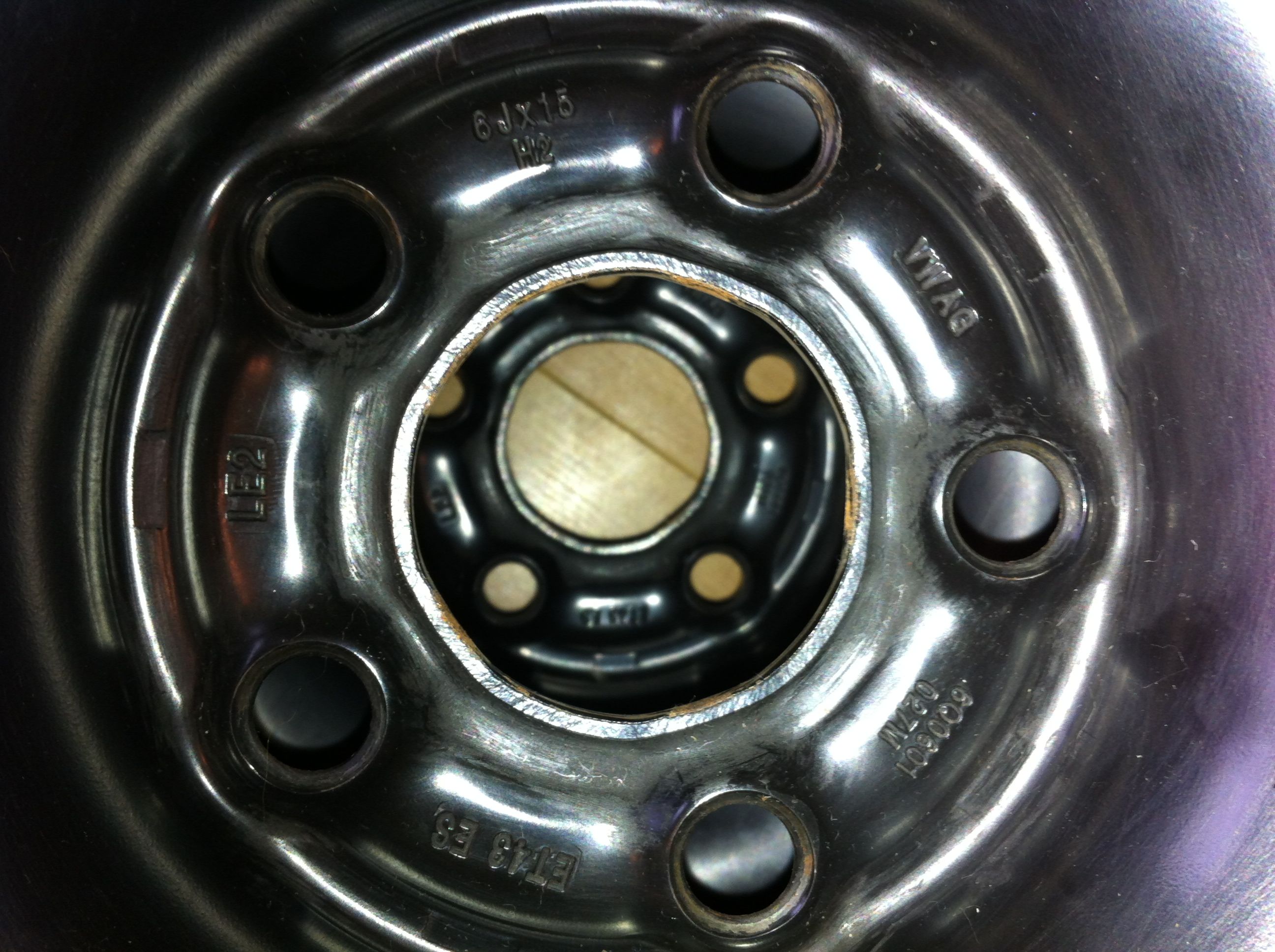

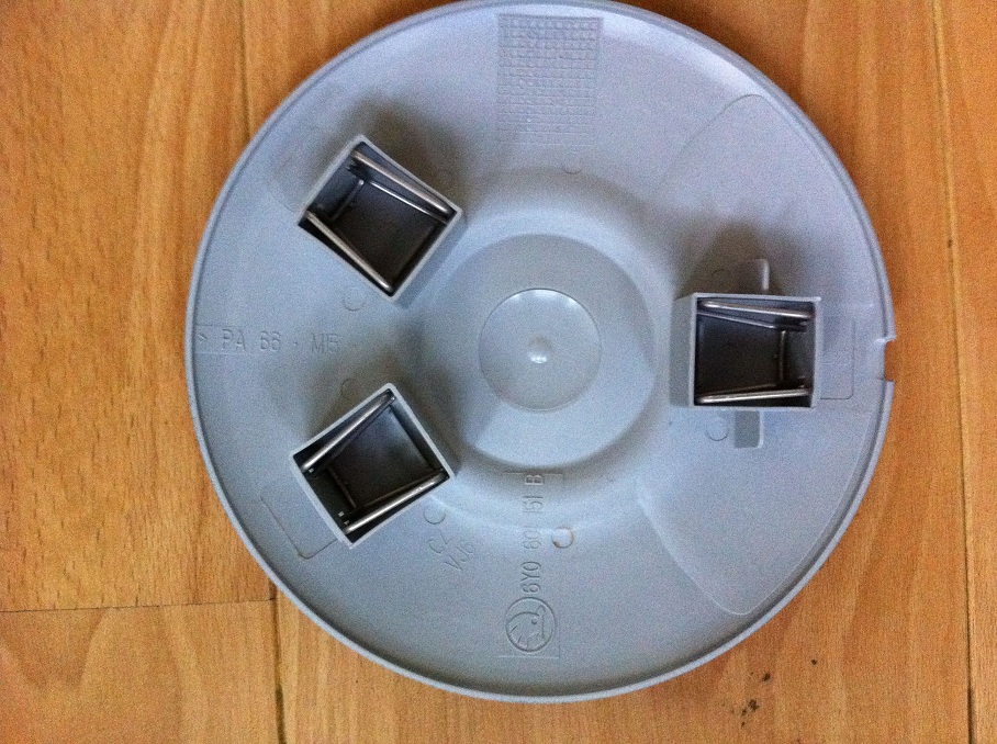

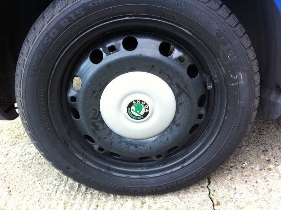

Ok so got the caps - they look like they fit perfectly and they do but they don't grab the bolts properly and will fall off as soon as I move :(
Pics attached for comment....
Hmmm, Does anyone know how the alloy bolts differ from steel wheel bolts, Could that be the problem?
Apart from the mounting issues, They look alright!
Black would be better though!
Yeah pondering spraying them black.
I thought the bolts are the same for both types of wheel? Or are they different?
They are perfect if I can get them to fit and stay on B)

Apart from the mounting issues, They look alright! Black would be better though!
Alloy and steel wheels bolts are the same, I wonder if its due to it being made for a wheel with different "dishing" - I'd check that it looks like the PCD is okay - ie check that a circle described that passes through the centre of the 3 (or the 5) bolt positions is 100mm in diameter. Maybe use a divider or something set at 50mm and place the centre in the centre of the inside of the plastic cover - it should contact the 3-off gripper points in their centres.

Looking again at your picture of the wheels that you have, these wheels were designed so that the (full) wheel trims were retained by lugs passing through the 6-off smaller "squarish" holes round the wheel and not at or only at the outer rim. VAG seem to have tried a few different ways of retaining full wheel covers on steel wheels, the cover (Golf) ones that I bought for my winter steels (14") were made to fit round the bolt heads and th eouter rim - and seeing that that version of Golf had the larger PCD, I ended up cutting that centre bit off and just using the "old school" method of using the outer rim. I'm mentioning this as it could be that you will never end up finding a small centre wheel cover that will fit that wheel - so end up needing to buy some Skoda 15" full wheel trims that meet with your "look" - but if from Octavia you might need to chop out the centre bits that were meant to grip the Octavia wheel bolt heads.

You might be right. I have tried looking at the caps again tonight and can't see anyway to get them to fit as they just sit on the bolts rather than grip them. Got a couple of spare bolts so I could have a play but they just sit in and are not even tight. Unless there is a special way to use the clips that I am missing?
Any other thoughts before I try to send them back? (Or end up with them gathering dust in the garage)
Looks like its a no go then..... :(
Yes, well if the Fabia wheel bolts by themselves don't give you the impression that they are getting "gripped" then you are really on a loser. Onwards and upwards, maybe time to see if there are any Octavia full covers that look okay, and then chop them up where needed so that they can fit.
