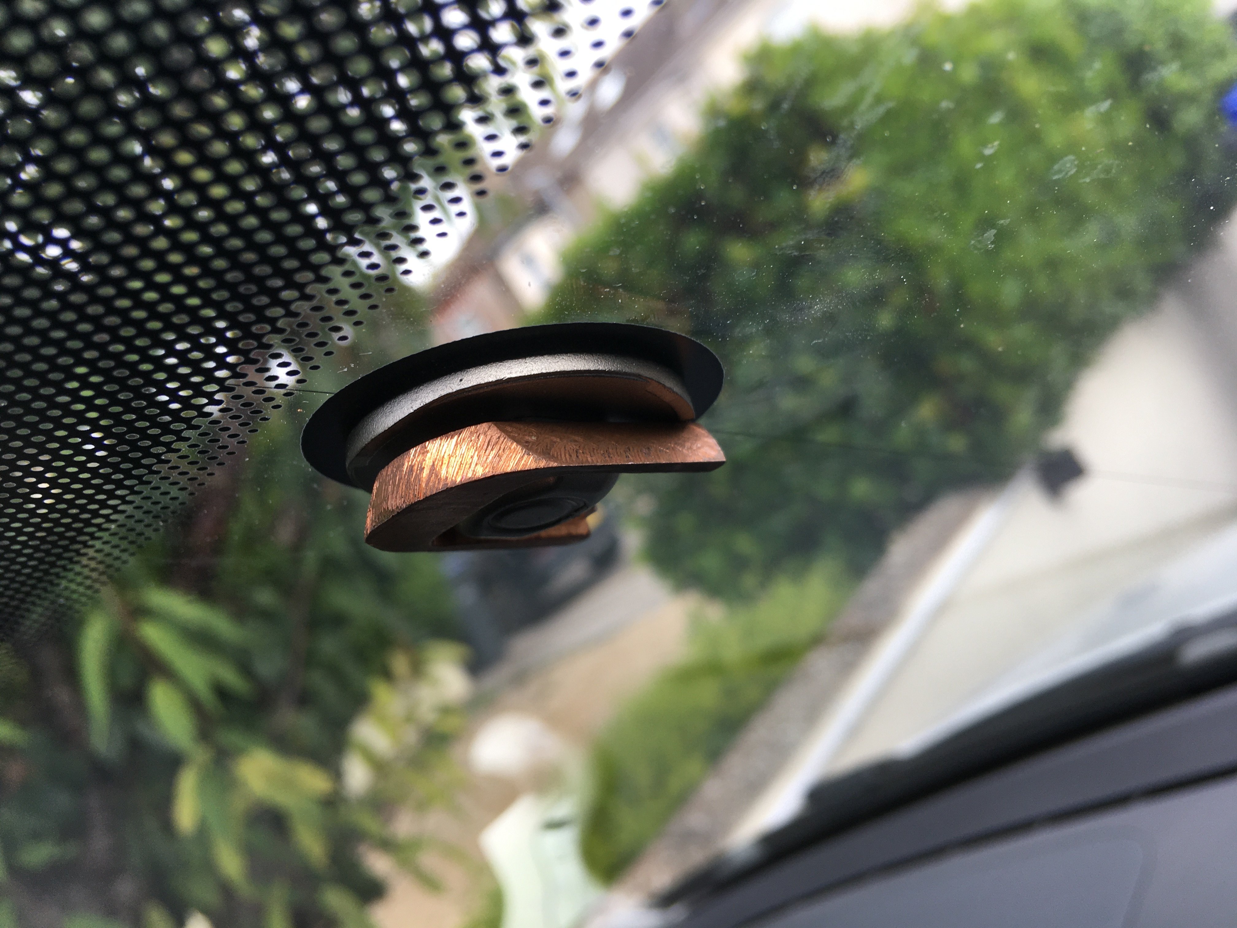

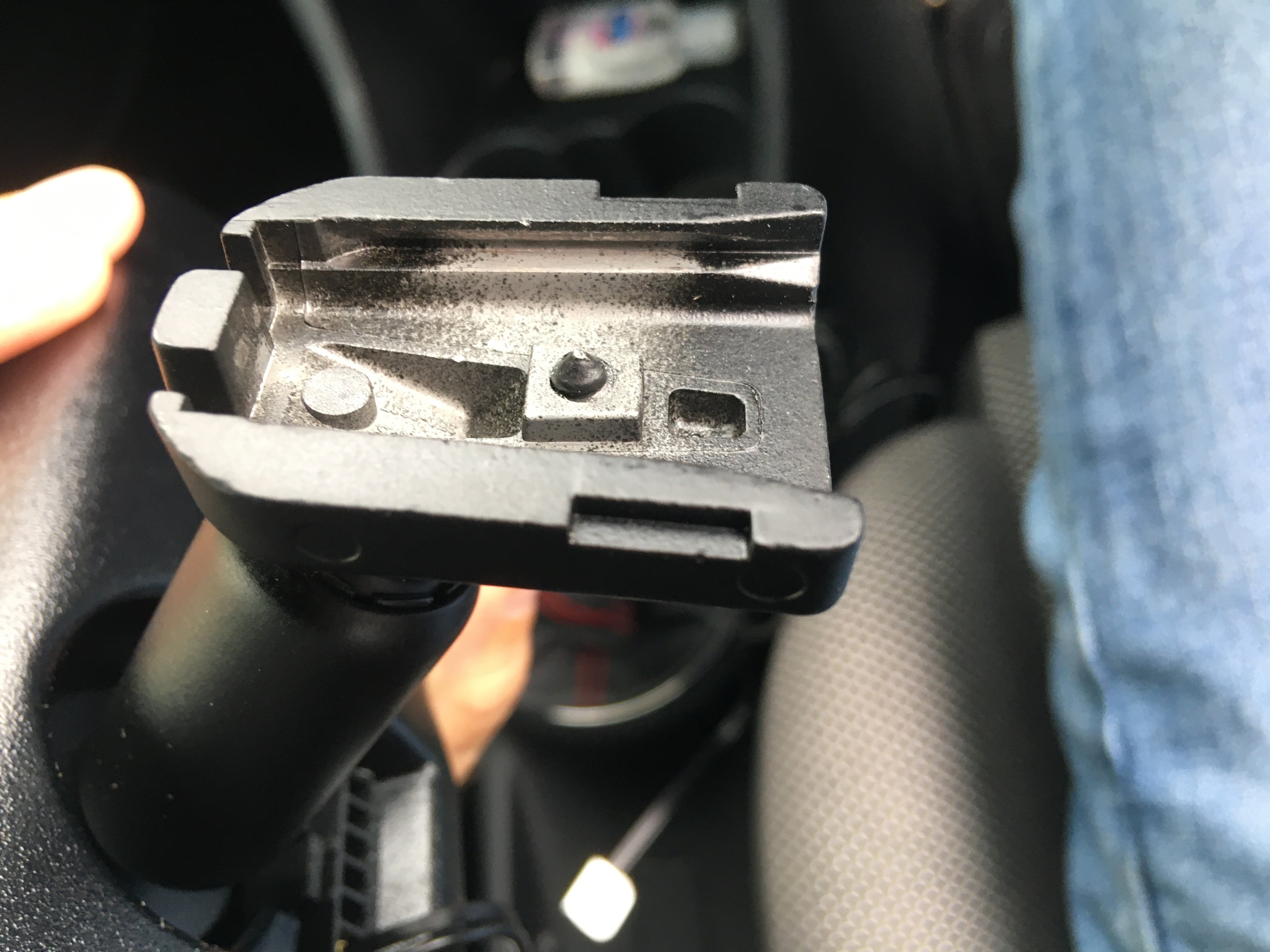

Hi green stripe, I got the exact one of these like you did. I have the same bracket on the screen and the same VW adaptor.  The thing is, I don’t seem to be able to tighten the Gentex mirror onto my bracket at all, it’s like the torx screw is too short or something and the whole mirror just sort of wobbles about on the windscreen Mount.  I’m normally good with stuff like this, but this has got me stumped 🤔  photo of the bracket, adaptor and the torx screw tightened up to maximum.  Any help appreciated.
Hi globalste - That was 9 years ago! trying to remember how it all went together. How does the horseshoe shaped adapter bit fit on to the boss and inside the mirror -mine wasn't very accurately machined so I had to grind it down slightly to fit -  does it go all the way into the mirror? Wondering if you have the opposite problem and yours is undersized, either that or it's  It might be worth getting on to the seller and seeing if they can send you a replacement adapter.
