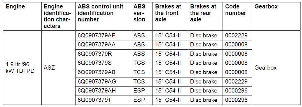

I'm just having a look through the VCDS label files to see if there's any clues in there.....
edit - It seems that my module is sort of "mismatched". The part number is 6Q0 907 379 AB which according to one label file is ABS/EDS/ASR 5.7 and redirects to the appropriate label file for that particular module.
REDIRECT,6Q0-907-37x-ASR.LBL,6Q0-907-37?-AB ; ABS/EDS/ASR 5.7 *
However, in logs and the VCDS main UI, it reports itself as Component: MABS 8.0 front H03 0001, whereas v8.0 modules in the label files should have a different part number.
The Fabia Factory Repair Manual agrees that my part number is a v8 module so I think this may be a cosmetic error on the part of Ross-Tech. From this excerpt, I'm reading that it's not possible to recode the modules as it is on the Golf chassis, but it actually requires a different module part number (for example see that my 6Q0907379AB module does TCS, while the 6Q0907379AA module only does ABS, even though both are coded with 0000008)

On a side note, these Factory Repair Manuals are awesome. It's like erotic fiction for car nerds. For example there seems to be a timer that records how long your brakes have had to cool down after application of the Electronic Diff Lock in order to know whether it's safe to use the EDL or whether it's likely to cook your pads. Might have to have a look at some of this stuff on VCDS later :)
