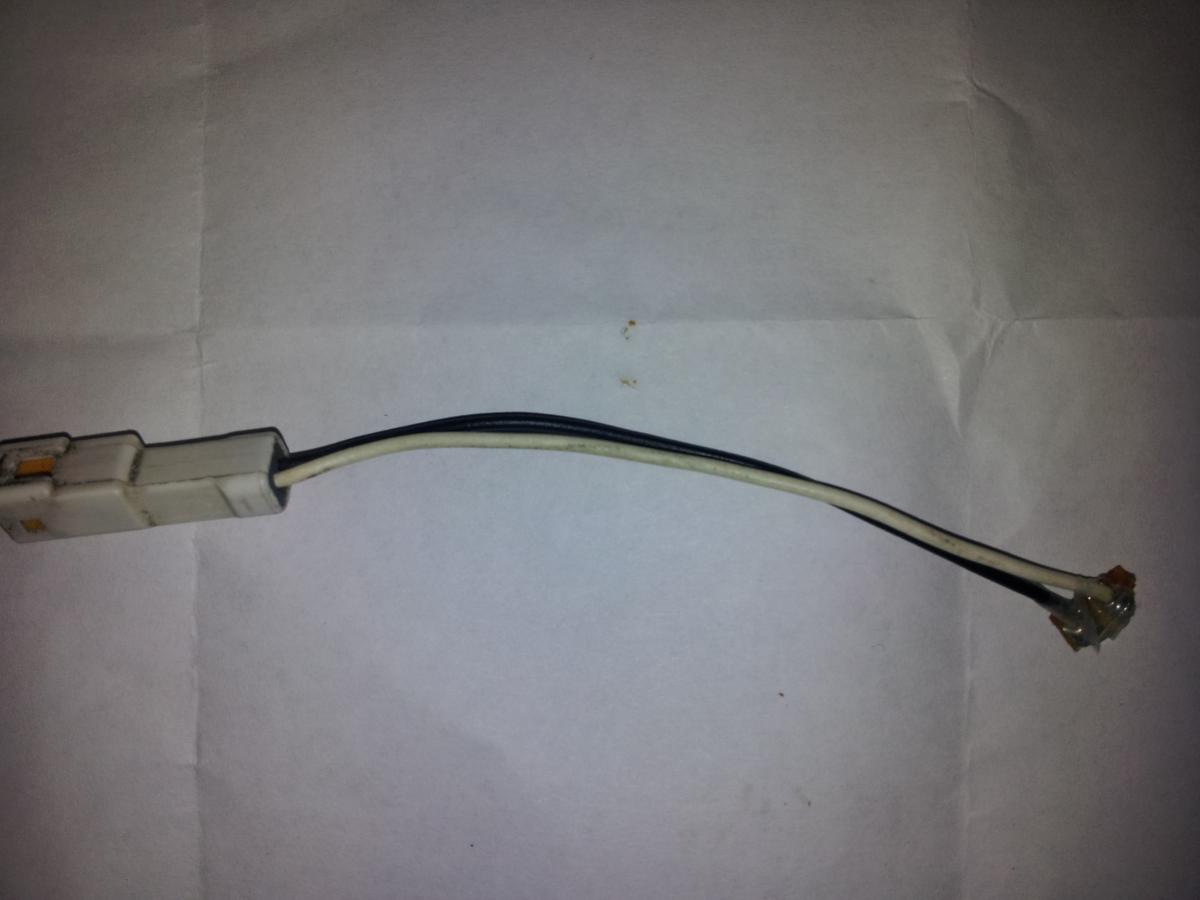

Hi, I wonder if someone can advise... I need to to replace my driver side led door indicator. Being a complete novice I was very please with myself having removed the unit and ordering a replacement part from euro car parts. I took it home and was disappointed to see the wiring connector was completely different. I even used my reg number to get the right part but it was still the wrong one. The connector in the old part had wiring that seemed to have been stick in place with silicone but the new part had a socket that you plugged the main wiring into. Euro car parts said the one I bought was the only part they did so I would have to go to a main dealer which to me sounds like its going to be a lot more costly compared to euro car parts price of £14.10. Can anyone suggest where I can get the part without going to a main dealer? I have an '05 Octavia Ambiente. The euro car part number I got was 477440601. My MOT is due in a couple of weeks so I don't have much time to sort! Thanks for any help.

Puddle lights are usually fitted to Elegance and above models, not sure about Ambiente. It may be the connector is different for the two, although yours sounds like its been tampered with if there is silicon involved as pipsyp suggests. Can you take some pictures?
Hi. I don't think its been tampered with as I have had the car since nearly new and it was immaculate when I got with full skoda history...perhaps my use of the word silicone was wrong. I've attached a pic of the wiring used. The white hard plastic bit connected to the wiring coming through the door and the other side with the 2 wires was connected to the led unit. It was this end that seemed to be attaxhed with what I called silicone but it seemed to be factory fitted
I reckon a plug is missing off the end that you thought was siliconed (or has been added in newer models and parts).  When I replaced mine recently, it looked different and had a plug on the end.
I recall when I was looking at parts for mine you could also buy a small loom (cheaply) for this bit as there was a problem with older ones. I didn't need it personally but it had a CC/DD prefix on a 1z0949101 part number, dependent on whether you had the puddle light or not.
See here for example: http://www.ebay.co.uk/itm/GENUINE-SKODA-OCTAVIA-MK2-1Z-WING-MIRROR-INDICATOR-ADAPTOR-WIRING-1Z0949101CC-/380704019133?pt=UK_CarsParts_Vehicles_CarParts_SM&hash=item58a3ba52bd

Thanks for that. I think it must have been added in later models. OK, I know what I need now.
