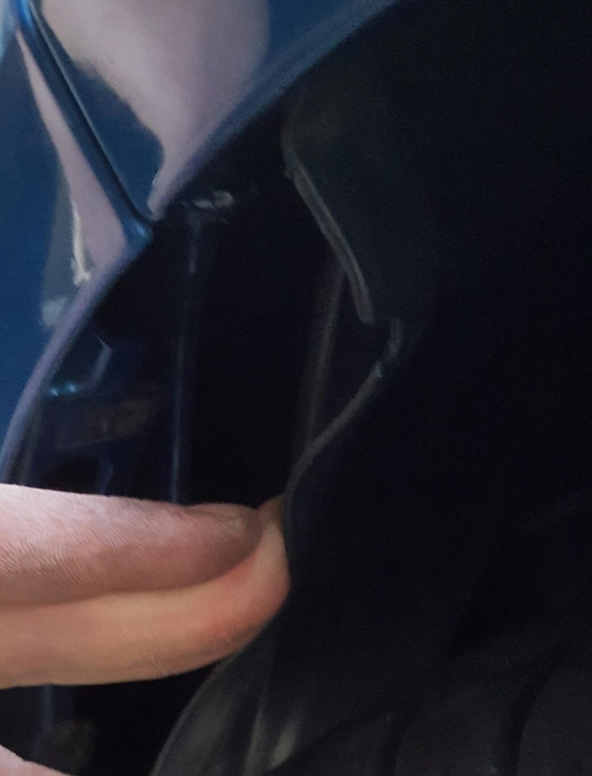

I need to get some Torx drives, what size needed for this job?
 From photo I'm guessing 25t - can anyone confirm pls ?

Help.
I have a hard time getting the point in this sentence (since I'm very novice in changing something on my car, I need to be 100% sure - lol):
"You need to wedge a flat head screwdriver underneath the head of the pin and force it downwards, this will release it."
Could someone show me in a picture (marked with red signs / arrows) where I have to put my screwdriver and force something downwards?
Thank you very much.
Cheers
I'm giving up for today. Didn't managed to get the last screw off. It's sitting quite tight and removing and holding the mud cover to get on the screw just ate up all my power - lol.
Tomorrow's a new day and I'll try again.

I did it - har har har! Feeling me like a king now :-). Have some scratches on the sides were the rear lights were, but can be easily polished! And better you start to begin clipping off the bumper from the wheel arch so the bumper goes off very easily.
It was quite complicated for me since I didn't understood the guide 100%, but the middle part of the locking pin should be pulled down (for every other non-english speaker) and then the holder of the pin.
Went to work with the Fab today and yes, it feels kinda different. More agil in the back (but not scary in any ways) and a little bit more rapid.
Just a hint for everyone: If you screw everything back, the lonely screw sitting underneath the wheel mud arch, just put it on the opposite way (from down to up). It's easier to get the screw's off this way for the next time you want to remove the bumper.
