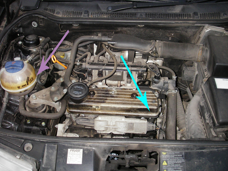

Bit of an update and some pictures (hopefully).
Went to the local Skoda dealer this morning (Startin near Worcester - most helpful) and have now flushed out the coolant and replaced with cheap stuff as a short term measure (to help clean the system out) until I can do the gaskets.
According to Skoda I need a new expansion tank, which I thought I could clean out. Having tried hard, I just can't get to it, so one of these will be on order along with gaskets, etc.
Having cleaned up a bit of the leaking oil, it seems that I do have the upgraded Temac gasket seal, but I do not know how long it has ben on there. Does anyone know when these were introduced (at least that would give a worst case scenario, but it has been on there for at least three years and 30,000 miles).
The purple arrow (left) shows the state of the expansion tank even after my best attempts at cleaning it out - time for a new one...
The aqua arrow (right) shows where I've had quite a bit of oil leaking down the outside of the cylinder head and further down i to the engine bay.

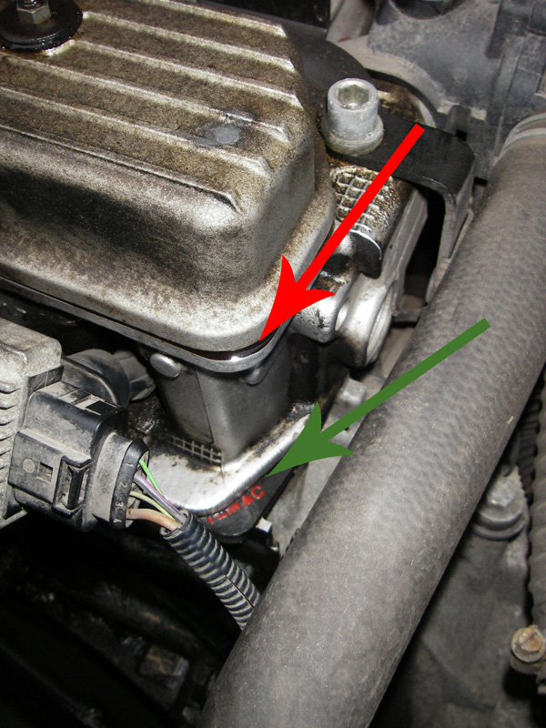

The green arrow (bottom) in this close up shows that I have got the Temac gasket and also, after I cleaned it up and ran the car around for a while, showed no sign of oil leaking here.
However, the red arrow (top) shows where oil is definitely leaking out while the engine is running. I've cleaned it three times today, and every time new oil comes back.

Does this suggest that just the top gasket needs replacing or is that just false economy given that the lower gasket is now a minimum of three years old?
The Temac gaskets were fitted from factory so could be an original, to be fair you may well get away for now just changing the rocker cover gasket.

The rocker cover gasket, where leaking from at red arrow, costs next to nothing. Might be worth replacing the 2 rubber seals on top too.

Rocker cover gasket definitely needs doing and seems like a pretty straight forward job (even for me).
The two seals on top are perished so will be replacing them as well, but I didn't get those listed so don't have a part number. Anyone any ideas or even what they are called?
I believe part numbers are rocker cover gasket - 047103483, seal - 047103532 (2 required). You should have plenty of change from a fiver. Don't do the nuts on top up too tight. Hand tight only.
Lube the new rocker cover gasket and the two grommets with new engine oil...the rocker cover gasket goes hard with age and heat and is the main cause for oil leaks!!!!!...also only a low torque setting for the two nuts..... B)
