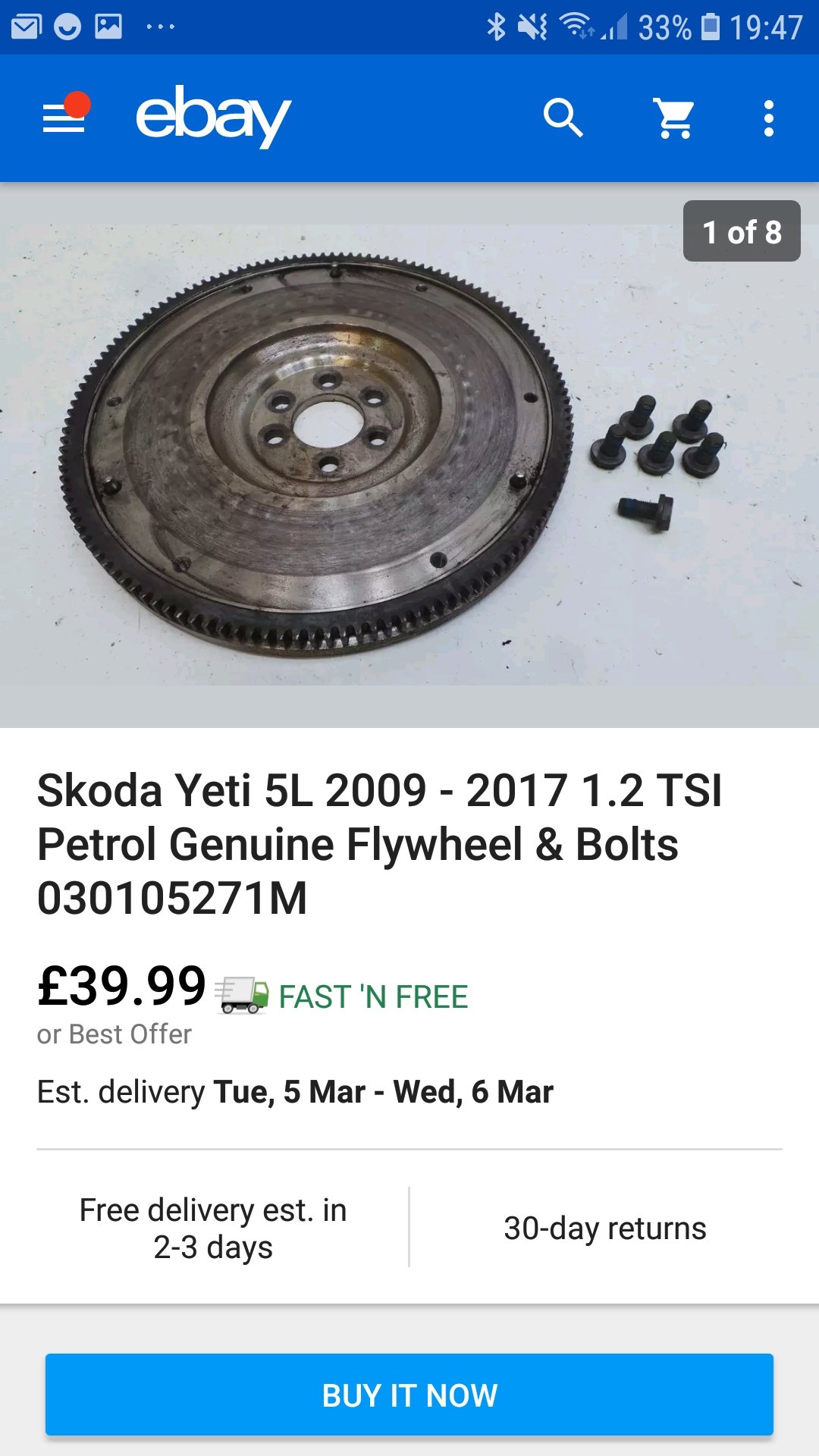

Mirroring what Tech1ie mentioned above, the 1.2 TSI 6 speed does seemingly have a SMF. The part number is 030105271M.
A search on eBay with that part number will bring up various examples of this part taken from breaking Yetis.
It does appear to me (after looking on various spares sites) that the 1.2 TSI Yetis that do have a DMF are the DSG models?
