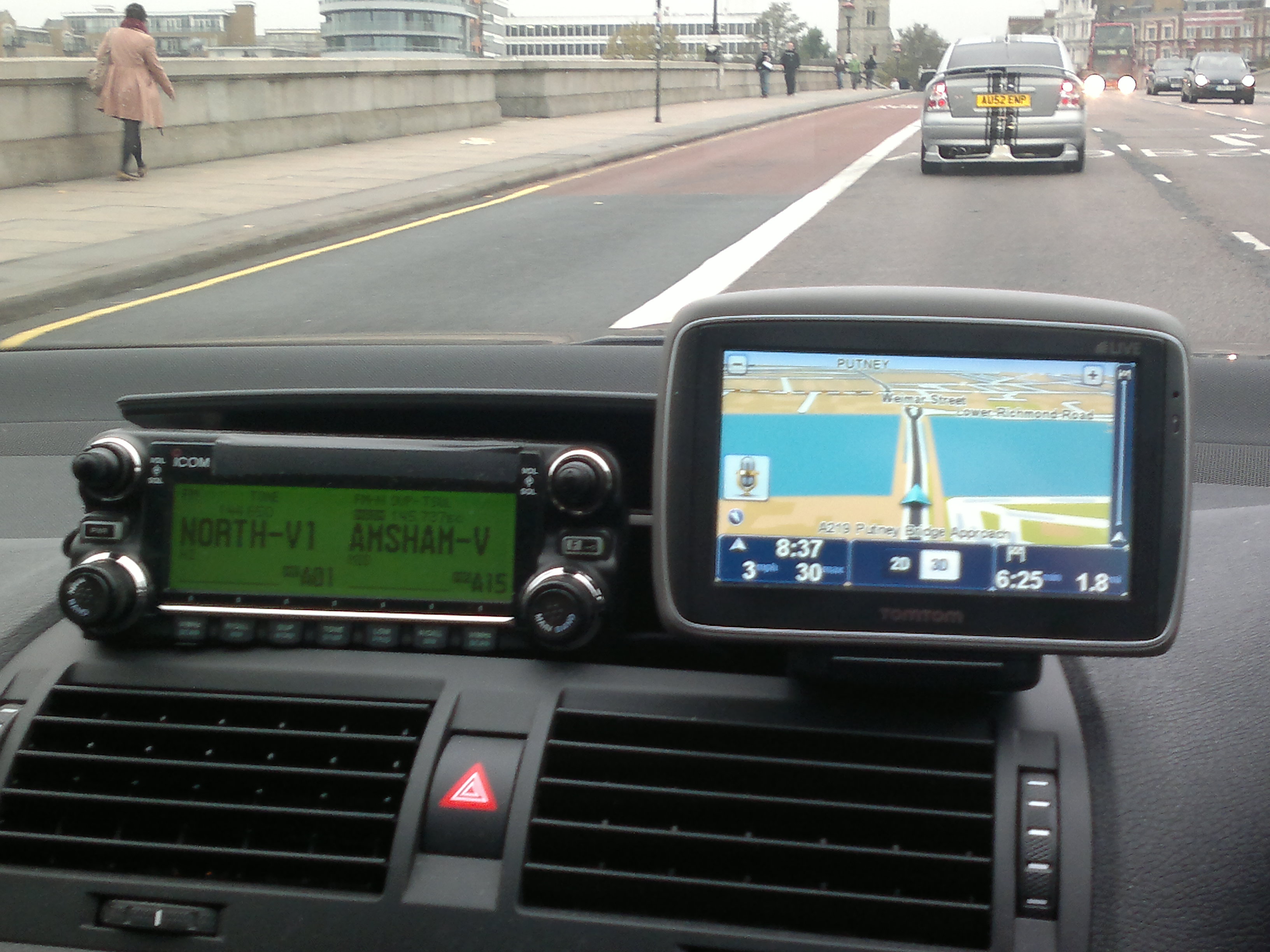

This is how I have my TomTom installed - permanently fitted active mount in the dash top box, then the sat nav unit can be attached when required.
This is for a GO750 Live and I have used the accessory "installed" mount, fitted to a custom fabricated bracket, that is designed to fit in the top box housing. Of course, the lid always stays open, but that doesn't worry me as the other unit (2 way radio control head) is always there.
Power is derived from the a switched supply from CAN Bus adaptor, so unit stays alive until ign key is removed - the lighter plug (which contains the 12v>5v regulated supply) is plugged into a wired socket located under the top box. I have modified the lid, so that it is no longer spring operated.
Incidentally, if anyone has a GOx40 or x50 series TomTom and is interested in this kind of set up, I have another top box, modified to be "lidless" with an active mount installed centrally - this is surplus to my requirements and apart from power, would be a "fit & play" solution. I would be interested in selling this if anyone could use it.
John.
By the way, I originally took this picture to capture an image of the "tasteful" rear skirt mod on the silver Vectra in front of me. :giggle:
Interesting approach. Which CANBus adaptor - the main gateway located behind the glovebox?
I used a CanM8 product which gives a switched 1A supply decoded from the CANBus - I connected it to the CAN twisted pair behind and slighly below the fuse box and above the pedals(from memory).
The adaptor basically switches a 12 volt + supply which I derived from the fuse box and holds it for 30mins when the ign is switched off but "key in position".
I use this feed to drive a relay, which then switches a 15A rated +ve supply that I use for TomTom and a roof mounted 8" DVD player/drop down screen.
The advantage of this is that when you switch off the engine and leave the key in, these accessories remain powered up - great with the children in the car still able to watch a DVD whilst refuelling!
