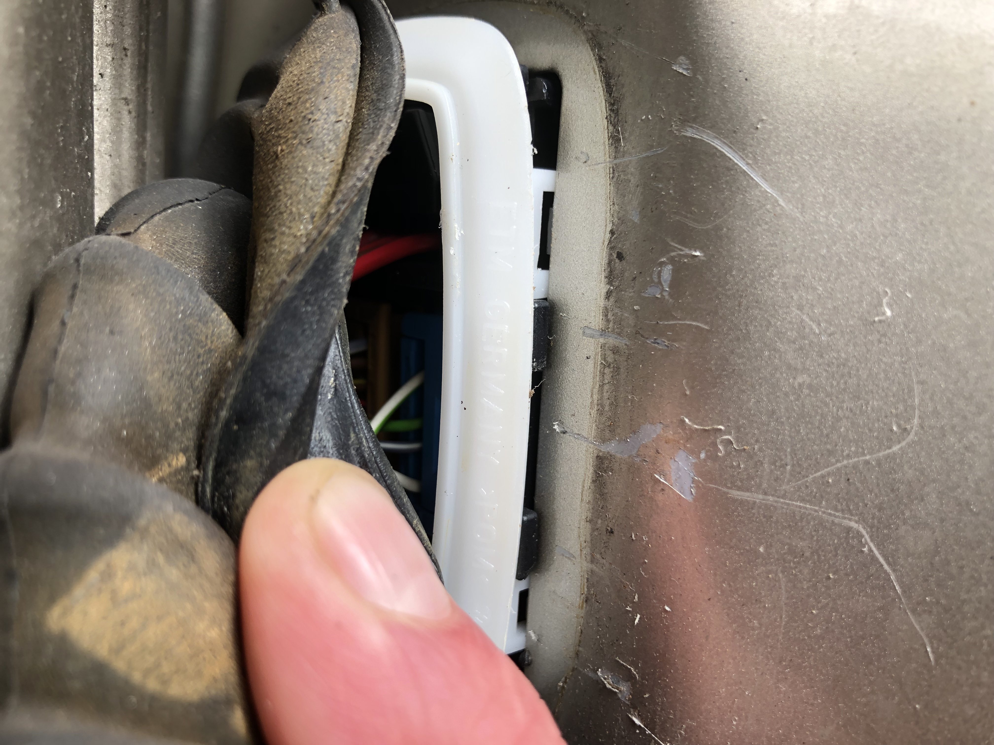

Resurrecting this thread to ask if anyone can shed more light on how the wiring actually unplugs. I see each connector is fairly buried inside with hardly any access with the door still on the vehicle.
Is the white plastic surround a retainer for the plugs or does each plug have to individually unclip (maybe you get more access with check strap undone..?)
I’m considering a used door to replace my dented one because there’s one in my colour at a breakers yard but would like to fully understand the procedure before diving in.

The white bit is intended to come out with the rubber boot still fitted to it, squeezing the vertical edges in towards each other should release the clips. Easier said than done TBF.
Then there are individual release catches on each of the four connectors that you will have slightly better access to with boot and white surround pulled as far back as poss along the wiring.

However you manage to get the white bit out, you definitely want to refit the rubber boot to it before you fit it back in at the end of the job. It's a real struggle to get the boot properly onto it in-situ, but really easy when it's out with all the cables unplugged.
