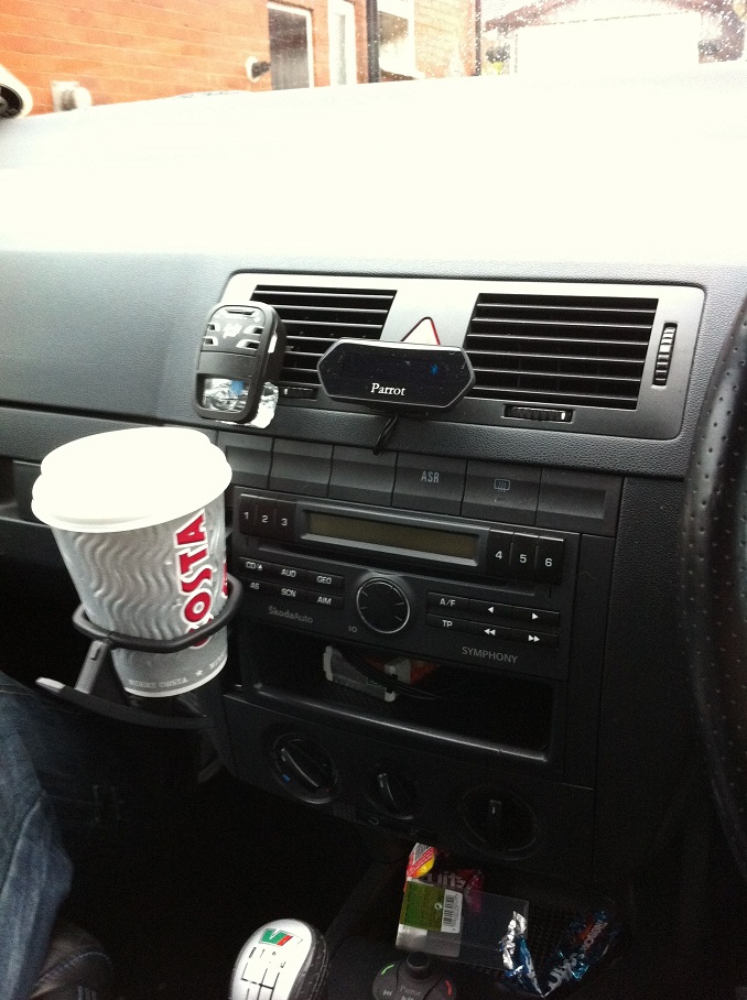

OEM Fabia Cup holder in VRS
Decided to get one and only took 2 mins to fit. And why not? I want my coffee where I can reach it damn it!! B)

Action shot! B)

Really easy to fit.
1. Pop top left button blank out
2. Pop heater control surround off
3. Undo top and bottom screws for blanking plate
4. Remove left blanking strip from radio (just pops off)
5. Push cup holder in down side of Radio and put the 2 screws back in top and bottom
6. Put heater control surround and button blank back in
Job done!

Anyone find that the cup holder will come out the dash easily enough but doesn't seem to want to clip back in? Got one of these for my fabia and it takes a good 5-6 tries to make the tiny clip get stuck, thus allowing it to sit flush with the radio etc..
Mine normally does it on second go but as I said earlier, It sometimes needs a push to go in but thats just because my buttons above are a little pushed in by my head unit after putting parrot kit in but it works fine for me really.
