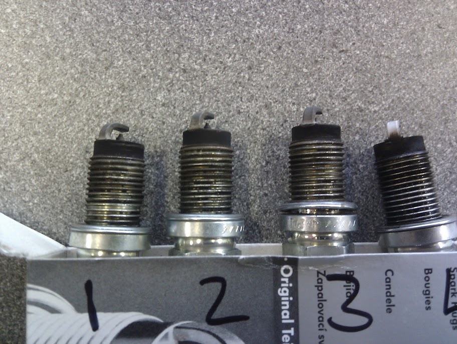

The ones that came out looked as if they'd been in the car for well, see for yourself ......
Image what I said when I removed them ! 2000 miles old ! emoticon-0104-surprised.gif
Looks as though they've been in for fookin ages !
Proper 'gungy' and sticky as well. Even the ceramic was sticky.The coil packs are completely unmarked though, so they're straight back on without a hitch.

they look brilliant compared to mine after 7k :o
These are from Big grays after 4k-Cylinder 4 has got so hot its gone white!!!!! Mine mad ehtese look lame :(
Now you see why i chnaged plugs and got the Pace radiator to reduce the heat on these plugs.

Here's wat mine look like, at 4500 miles now. Looks like it been running rich an hot :S
Damn! I need to get mine changed pronto me thinks !
those look so so bad, you can really see just how hot these engines get. I suspect they generate more heat than VW had bargained for, it will be interesting in the summer to do some logging on water temps
