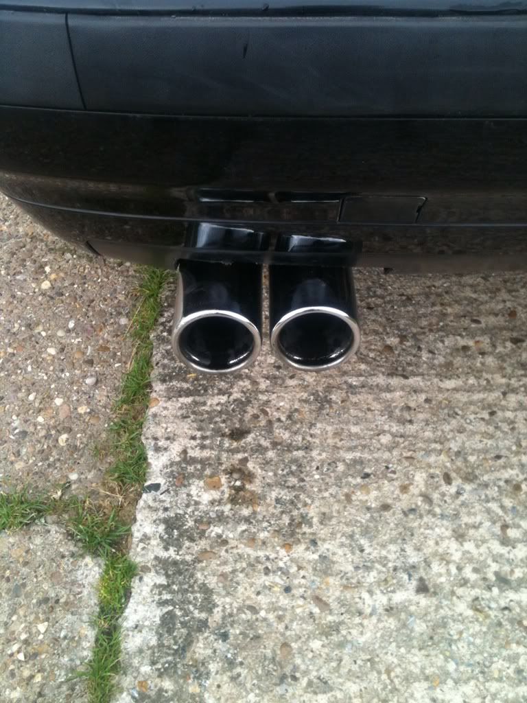

So today I decided to treat it and fit the de cat supersprint system that I've been tripping over in the garage :)
Not to loud but it don't sound bad for nowt :)

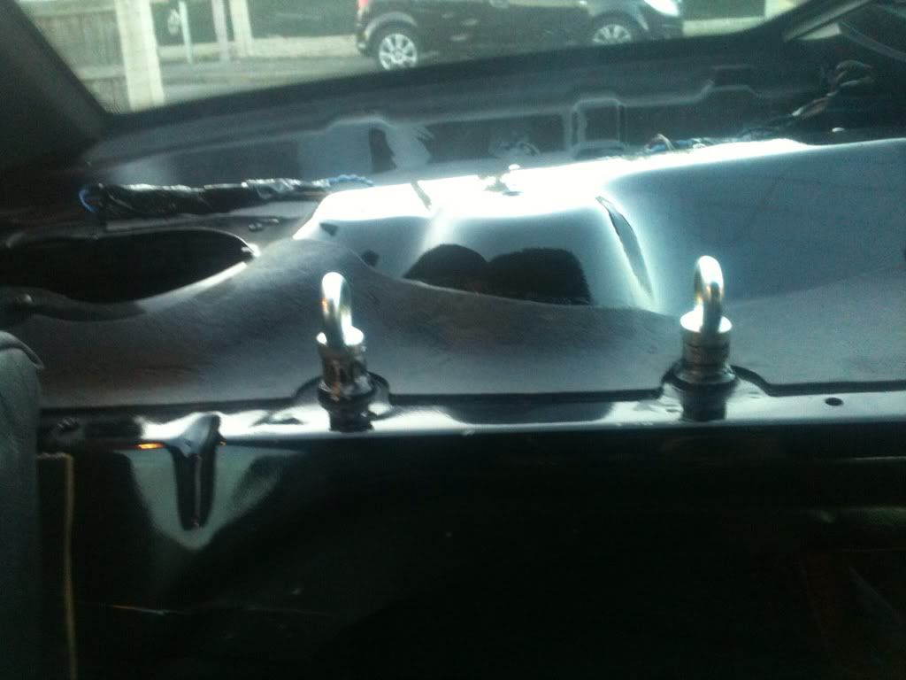

Now the rear shelf's out I managed to fit the harness eyelets, cut down the headrest mounting's down as they have a split in for the securing pin to sit and hold the headrests in.
Ended up with this, just need welding in to make sure there 100% safe :)

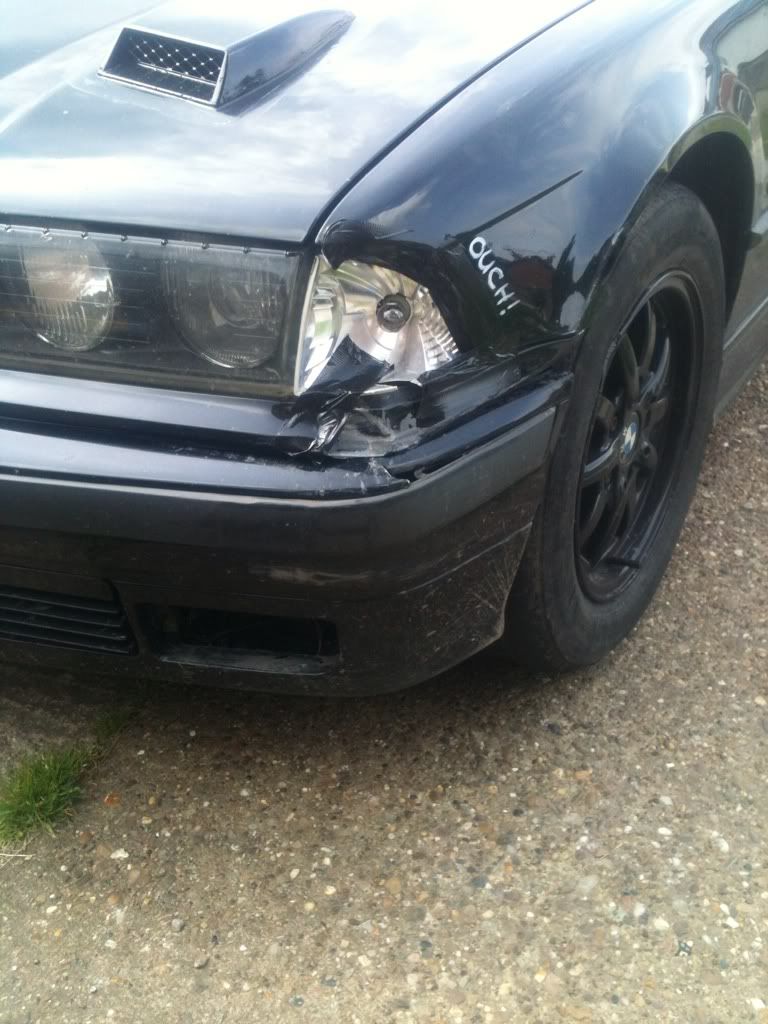

MOT day today.
Also going to assess the bucket seat situation again, had a go yesterday and it didn't play ball.
It passed!
To celebrate we decided to have a play round his unit.
Which resulted in this...............:)
The 1st of many no doubt :)
Did you say at any time "Watch this!"?
No thankfully :)
Couldn't stop laughing though, it just gripped mid drift and shot forward into some railings. There'll be more damage by the time i'm done with it so I'm not to worried.
You'll need an amber bulb in there, plus it may fail an MOT test with that damage.
