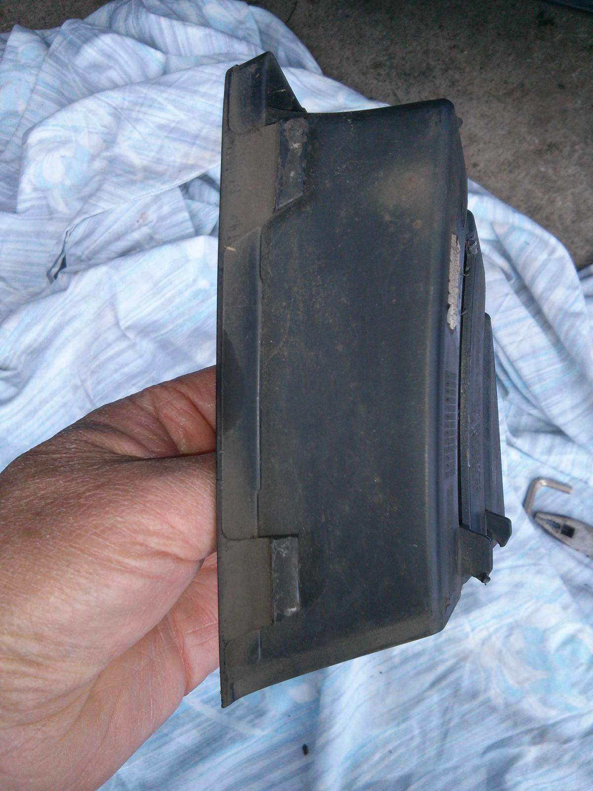

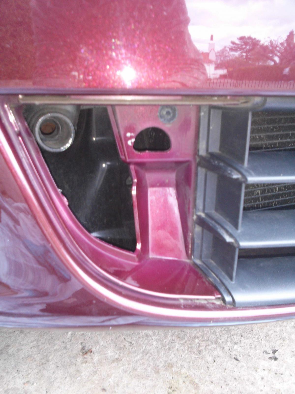

After a lot of struggling I managed to get the front trim off approx as per the handbook. Once you have it off and in your hand you can see it is designed purely for snap in assembly when new; i.e. not designed as a removeable part for access to the DRL/foglamp assembly. Fortunately it came off with only minor distortion of one of the tangs and has gone back OK. I took a few photos which might help "first timers" attempting this. However I am not sure how to upload them as they are greater file size than the 1MB this Forum permits so I will need some guidance on how to do this.
Also I used an "L" shaped tool to hook through the "finger" opening and pull the trim towards me.

Further to the removal of end trim dilema.  At last. Finally had the nerve to go at it! The perfect tool is a junior hacksaw. Remove the blade, insert the short bent length into the slot pointing upwards and pull like f~**. Nothing broke either.
