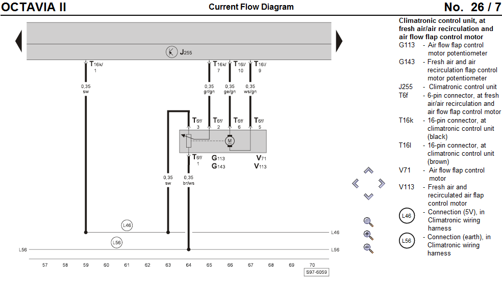

OK, plot thickens, having taken the glove box out, breaking a bit of the silver trim above it, and swearing.. it would appear I have 2 motors not one to control the climate control..
From what ive read and what ED has told me these would need wiring in parallel to get them to function correctly, can anyone advise on this?
It seems odd to me that Rob didnt have to do it on a 2006 model which I can only assume has the same 2 motors mine does... so unsure if its just an issue with either the climate panel ive got working different to some slightly older ones, or just me!!
Anyway, picture below if anyone can advise... if i need to go chopping more wires to do this them ill shelve it and sell the climatronic panel on...

Hmm So here some pics that might come in useful
Two Flap Wiring
One Flap Wiring
Well i know over on a VW forum there was plenty of chat about this and having to wire the to flaps in parallel to be controlled as one unit... Not sure about how to do it as the form was german and translating to english was a bit sketchy... however I get the impression Ed on here knows all about this and may have a solution.. but if it involves too much effort I wont bother, its a feature I can live without really as I seem to be throwing too much money at a cosmetic mod..
If its just a case of cutting the cables to the 2nd motor and then wiring it in parallel it should not be too hard. Fairly good access to the area

Looks like its:
Motors in parallel:
On C Connector (brown): Pin 7 connected to Pin 10 and Pin 8 connected to Pin 9
On B Connector (black): Pin 6 to Pin 7
