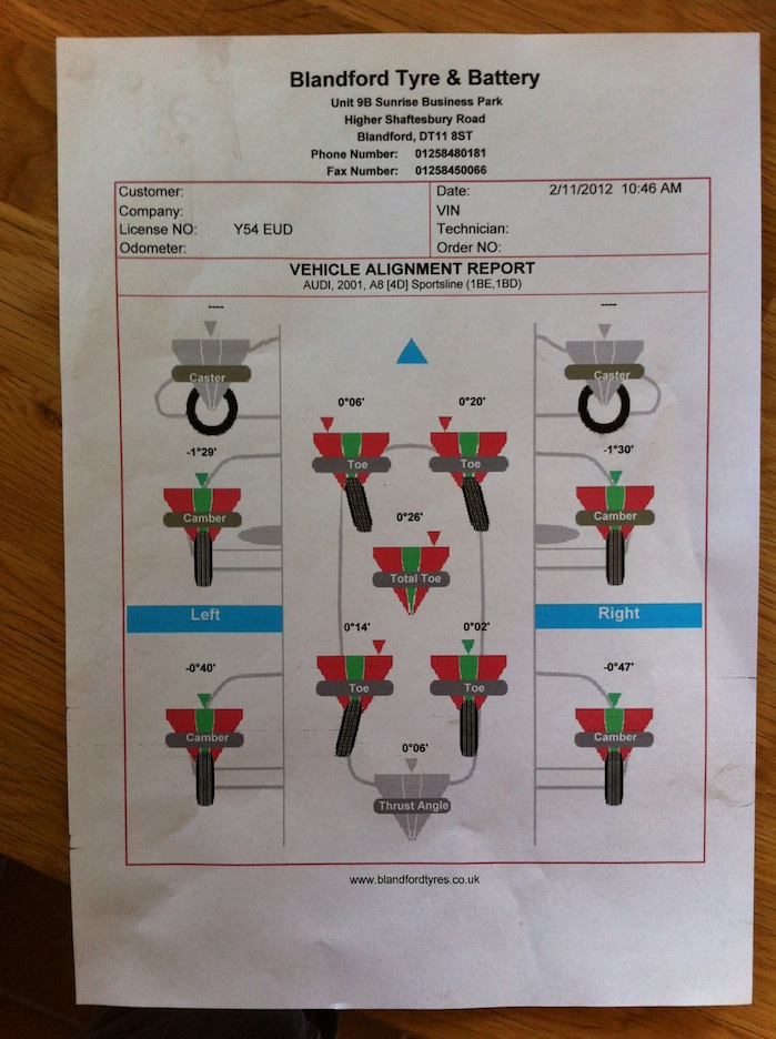

So off I trot down to Dorset, and today had all 4 tyres replaced (245/45x18) and a cost of £500. They stick the car on their 4WA alignment rig (not sure of make maybe someone recognises the attached printout), and get a totally different set of readings suggesting the alignment is out. The car has only travelled 180 miles since the last alignment, and not over any pot holes.
The car drives fine to me, although I will pop back in a few weeks to the other garage I have used for years with this printout and see what they say. I have never used this Dorset tyre place before, but they are part of the protyre empire (good / bad?).
The attachment is the Dorset protyre printout.
How bad are these reading, of course I am not sure at this stage if these are the true readings.
That print out is off John Beam machine that is supplied by Snap-On. I use the same mechaine and its REALLY GOOD as long someone know how to use it. If its a print out from initial reading then get final. If those are your final then they dont know how to sell alignment.
Front toe is set to acceptable level but during print out they had sterring wheel out and thats why uneven readings on front. I dont know if that effects your wheel. If its fine I wouldnt bother. your front camber is spot-on - caster as well so happy days.
I dont remeber rear suspension on your but if its multilink then they didnt bother to adjust is. I dont like to use this print out and it doesnt give reading before and after and I dont know at what stage of work they did that, so its kinda hard to take a position in this matter.
I just have this one, they have not done any adjustments, this is the result of their free alignment check. I am going to take the car back to the garage that did an alignment the week before to see what they say. Only problem is that garage is 150 miles from here, and I am not heading that way for another 3 weeks yet.

That would be me who done it :giggle:
mannyo... free check. Well this explain all. It doesnt look bad but there is room for proper adjustment. :thumbup:
