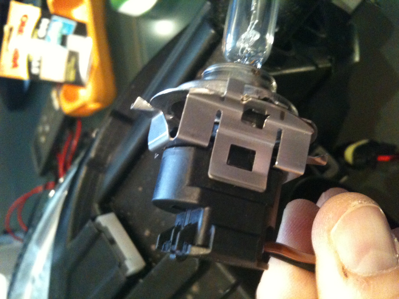

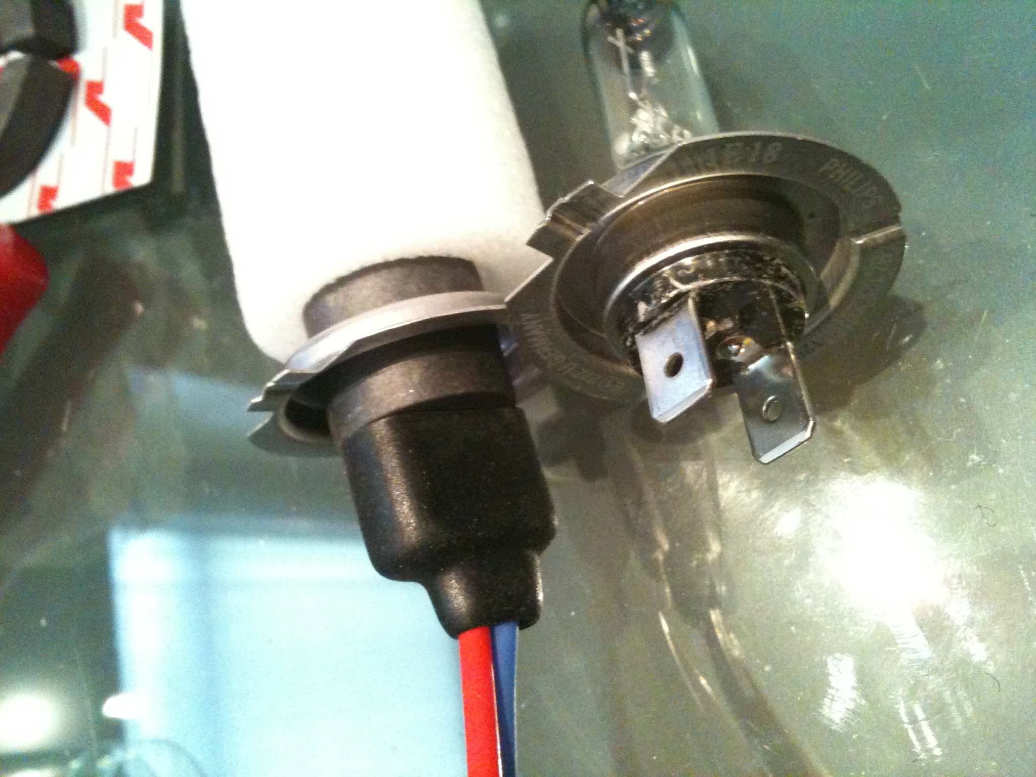

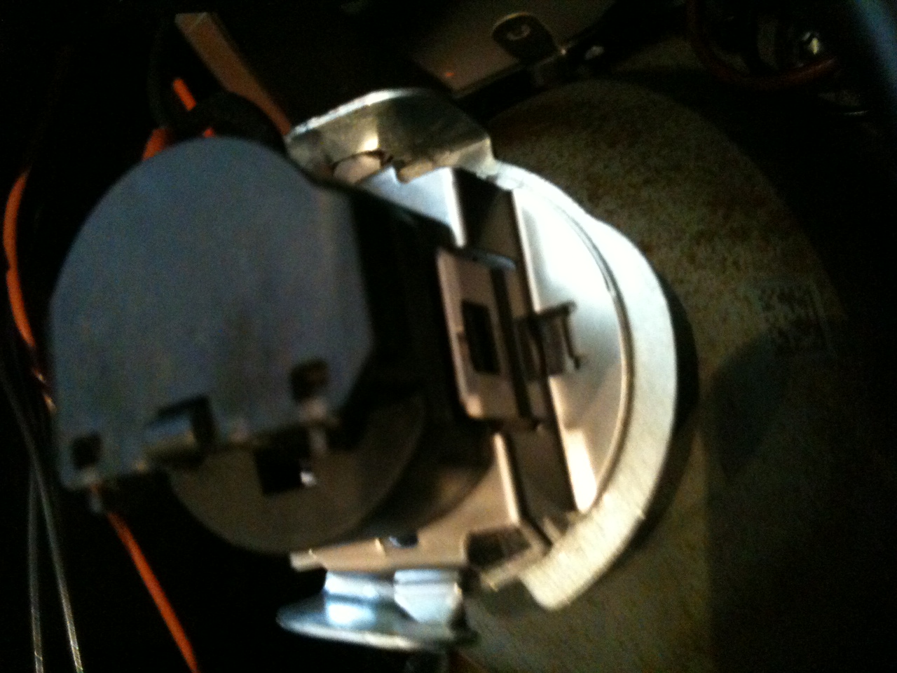

FFS! - Found a nice little HID kit on Fleabay and thought I'd pop it in this morning. Went to swap out the bulb and came face to face with the new fangled method of holding in a H7 bulb that Skoda has seen fit to introduce on the FL.
Gone is the bent spung loaded wire clip and in comes a stainless turn and click holder which makes adding the aftermarket bulb impossible. I've looked and looked and just can't figure a way of changing to a HID bulb wit the current clip arrangement. I'm pretty sure I pluged in my brain this morning as well :-(
What in Gods name was wrong with the holder on the Pre - FL and it seems 90% of other vehicles?
I can't be the first person to attempt this .... can I??

You can buy modified clips off eBay mate
Yeah thats the ones Im sure someone has put HIDS in a FL
Yes I have recently put canbus HIDs in my FL with stock clips....... But the problem em facing after installing is that the light goes shaking/shivering in potholes which is very irritating. I think the halogen projectors headlamps are not designed for HIDs.
The thing is I'm quite happy to snip a section out of my OEM clips with the shears however I think the lack of the pwer connector when using the HIDS will result in loose burners as seen by Alam.
I'll give these a go but I'm not convinced.......
watch this space!
watch this space!
I fitted them in my FL octy. Can't remember what i Modified but it works 100% without the need to buy anything extra emoticon-0148-yes.gif
I have the same and did not change anything
The only thing I did was to cut/file the sides off the HID plugs.
Their is a certain position for the metal piece to adjust to the HID bulb.
Yeah I know that, I have done the same.... But does your HIDs shakes/shivers slightly in potholes, just want to confirm that....

Clips as above arrived today - Tim31 they do not fit!
Can somebody actually point me at a set of clips that WILL fit and also clarify the coding question raised by Alam? My kit is non-Canbus as recommended a thousand times on these forums. :wall:
This is a new one on me - didn't realise there was no option in VCDS to do this. Are you sure it's not just a "feature" of your vehicles in India?
I sincerely hope you are wrong! As far as I've been lead to believe you have to access controller 9 and set it to 'xenons without shutters' you can also turn off the cold diagnostic there.

I have a FL vRS Octy and have as recommended here fitted NON canbus kit. Got my Dealer to re-code for them.
I also used the original clips, I think I snipped them somewhere and got them to work. I have absolutely NO shake from them.
