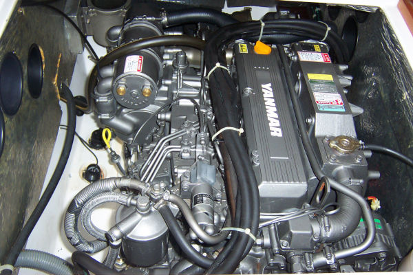

You do know that virtually ALL diesel engined motorboats change their oil using suction pumps don't you? in fact these suction pumps were originally developed for this application and it's a bit tricky getting to a sump plug (if they even had one) in the engine compartment of a motorboat... :giggle:

So you'll be buying a pump then!? :giggle:
