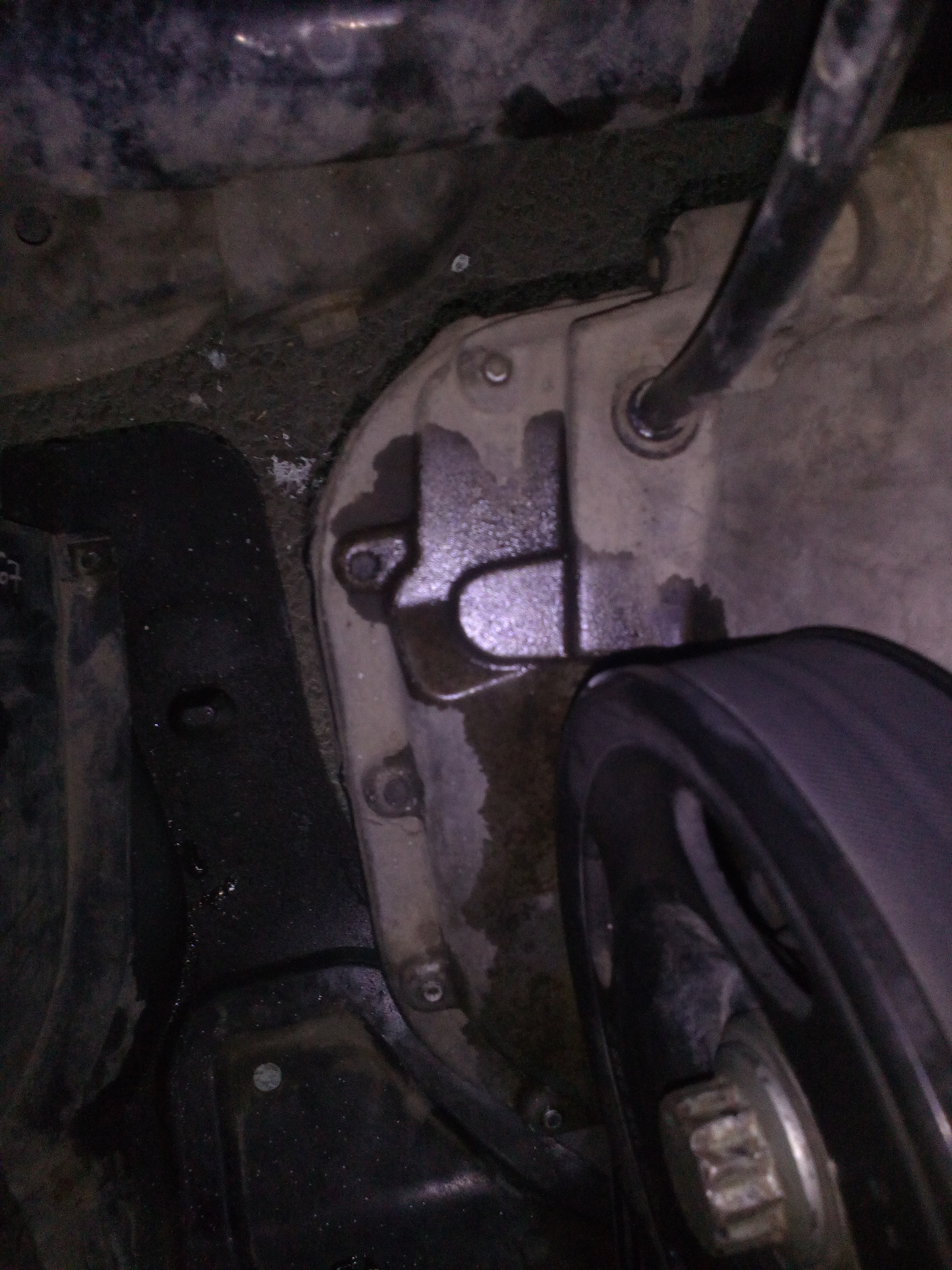

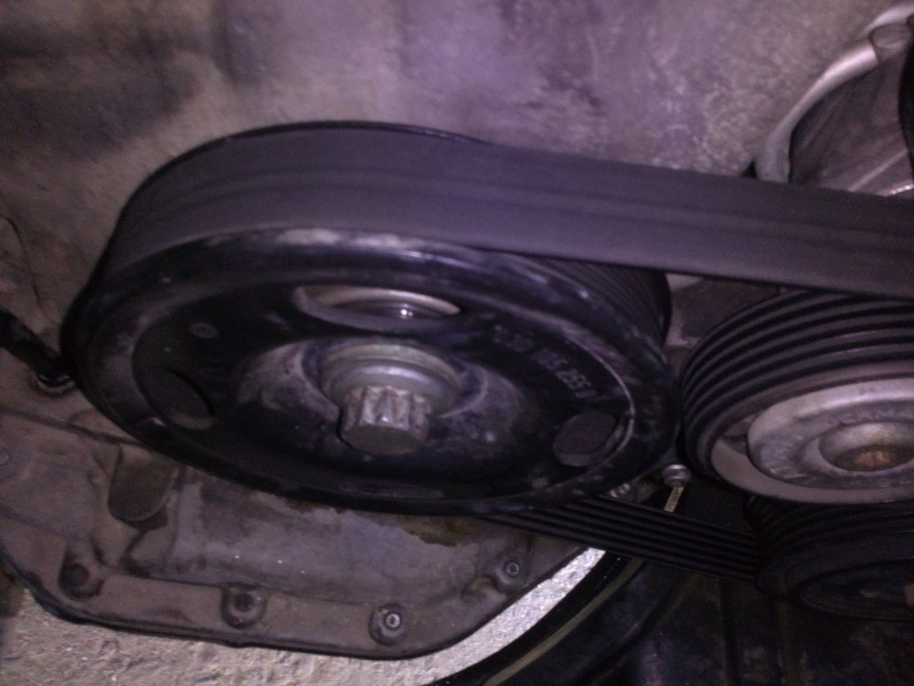

Hello. I m new on this forum, and i have a Skoda Fabia Sedan, 2006, 1.2 Bme, 47 kw. I changed 2 times the front crankshaft seal (Oem), but still leaking. My mechanic says the oil came up to down, and is not faulty the front crankshaft seal. Can be the oil pan gasket with problems, cap of distribusion? Any advice will help me. Thank s, and excuse for my english.
