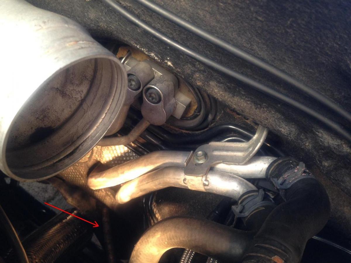

I noticed there is another shielded pipe that runs above the exhaust heatshield from the engine bay, can anyone tell me what this pipe is, I have arrowed it in the attached pic (sorry for poor quility).

The other part you have labeled is a gearshift cable.
