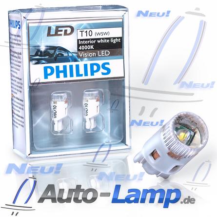

I'm also a big fan of led number plates lights and i first bought some w5w leds with 9 smd and they died after 2 months. After more searching i found Philips leds.
I have them for 8 months now with no problems. I used them for the number plates lights and in front as well. Here are 2 pictures at night, but with the telephone, so, not the best quality.
There is also a C5W Philips led and i will buy it for the interior + another set of W5W's
There are 2 temperature colors, 6500K and 4000K. I recomend 4000K which is whiter and brighter.
