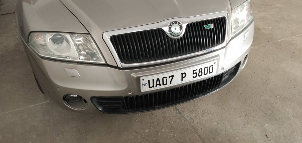

Hey hi.. I am from india can you please tell me from where did you managed to get or send me a link..
Would be very helpful. Also suggest where could i get this fog lamp coverIMG_20190510_160212.thumb.jpg.e13be5aba57b848848ebd3c13904d107.jpg
