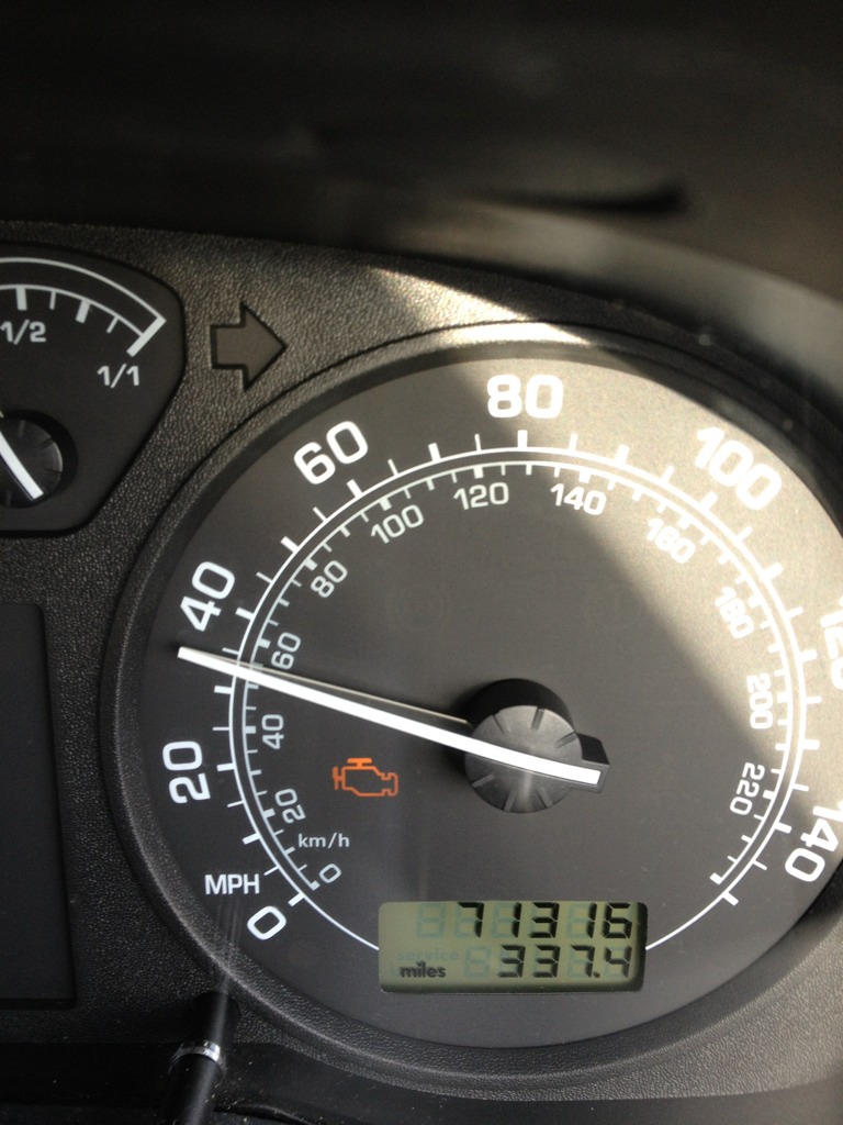

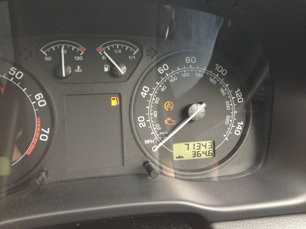

Have a slight problem. Was driving over to the parents this morning to pick up the bike and go for a little spin(bike is in the garage) and got an orange engine light come on. Rang a mate and told me the errors I cleared from the ecu last Monday might be just coming up again.
So went of on the bike. Came back. And started driving back home. Noticed car being really sluggish. No power. Mpg dropped drastically and the asp light came on.
Any recommendations?
Not sure if the photos uploaded as using tapatalk on iPhone. But it's just pictures of the dash incase it didn't.
Did you turn the traction control off or when the light came on did it pop up?
Possibly the MAF or a Coil pack
Unplug the maf and see if there is any change in the engine note... if not then its not the maf then try the same with each coil pack. Ideally you need to scan the car and get us the fault code. The EML lights stands for many faults.
Never touched the traction control. Pressed it when it came up to see if it'd turn off but it didn't.
