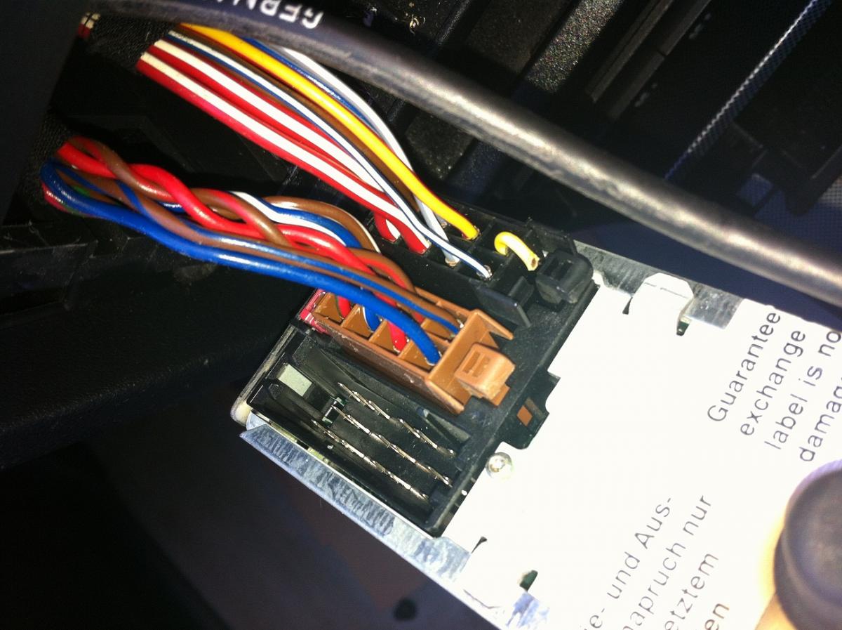

Update.
Change of tack on my google searches and I might have found the problem.
No connection to the CD changer. See attached pic.
Would appreciate if someone can confirm my suspicions.
Thanks.
Bob.
Edited by BobSmoke
Yeah you need a third plug for the changer
Thanks bud. I've just been scratching around inside the dash (had to remove the glove box) and found the plug tucked away behind the bulkhead. Plugged it in and lo and behold, I now have a fully working ICE! Just in time too - I was fully sick of listening to Radio1 haha!
