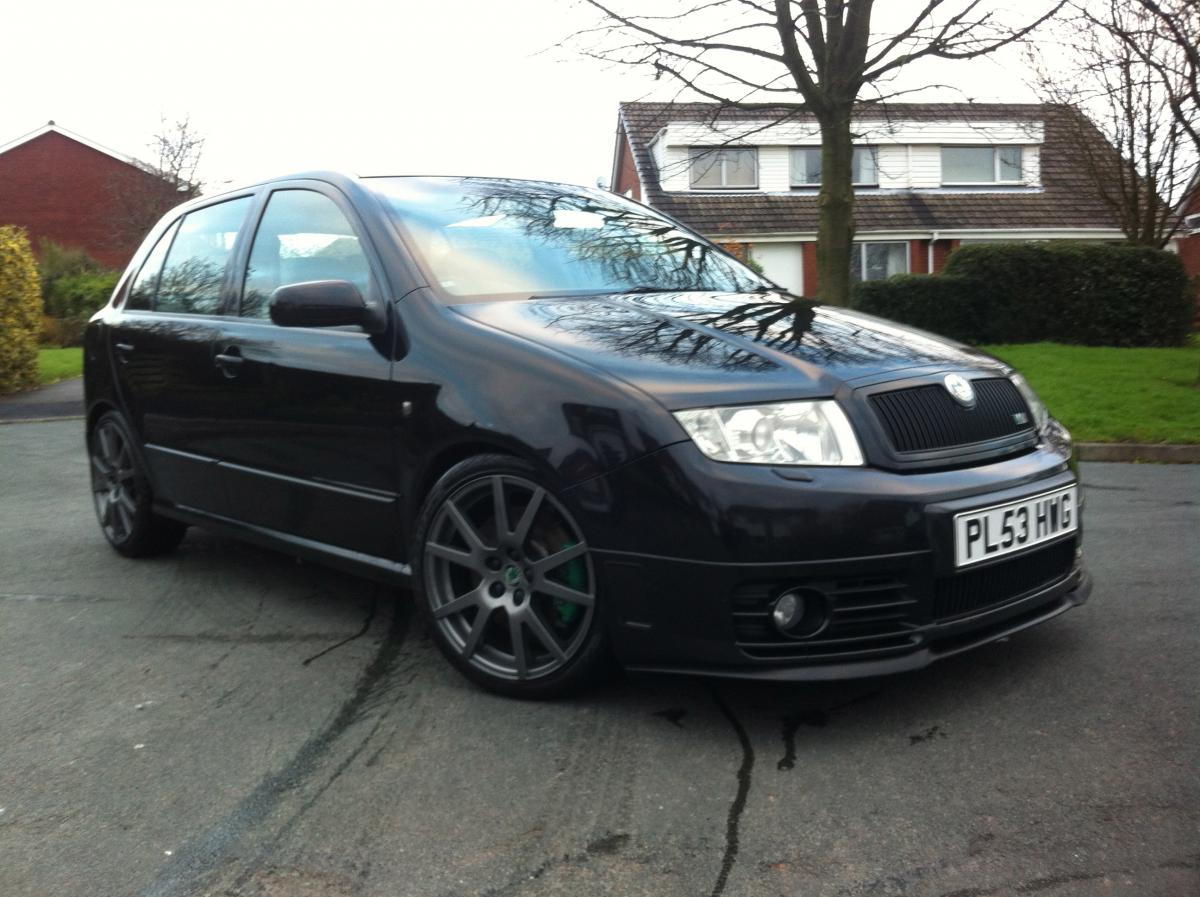

Ive attached a pic, thats with them wound all the way down just after fitting so they do settle a bit more. they adjust different to other coilovers i've used due to the actual shock body moving up and down to adjust ride height and the spring platforms move to adjust pre load on the spring. the rear is also adjustable this way with both the shock and spring platforms able to be adjusted.
