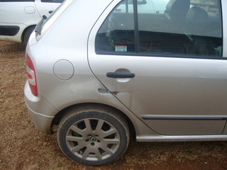

I was wondering if anyone had an idea of the work, cost and time this would take to rectify this horrible dent .

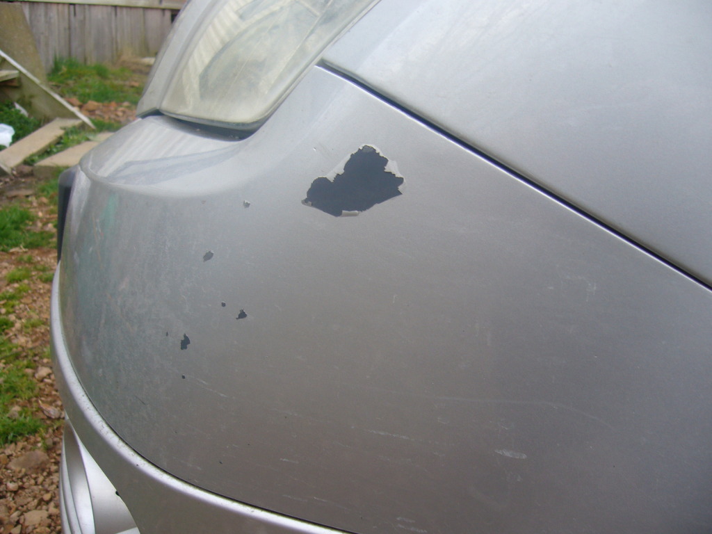

Its been there for almost two years and I am sick of seeing it ! I am based slightly north of Inverness so appreciate I probably wont be spoilt for choice!! The pic of the bumper probably do myself but any hints tips would be good. Ive not done anything like that before.
Thanks in advance!!

I bought mine insurance cat D because of a similar dent/scratch to that. Anyway, the work.....
The door i replaced £50 (was pointless really as i got it sprayed anyway, but at the least the dint was gone)
The rear quater was abit more tricky for me as my dent was slightly higher so the line needed to be put in from the petrol cap. I got mine pulled out as best as they could get and then filled and sprayed. My sprayer told me he would need to spray onto the door to blend the colour and around the sills etc
i was quoted between £250 & £350 to get it fixed, but it came up in a conversation to somebody who was more than happy to do it on the cheap. A few places wouldnt actually touch the rear quater because of the colour silver being such a hard colour to match.
Hope this helps.

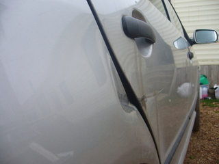

How good a job was your repair? At all still noticeable or totally seamless? As you mentioned about price in a conversation I take it that means I will be looking at 600 or so ? How much did you get pulled out before they used filler if you know ? Just the rear quarter looks almost folded over on itself .

My damage was worse than yours really, the quater was pushed and scrapped in quite abit. I was there when all the work was done to watched it start to finish, the dent was pulled out quite alot but there was only so much he would do, he put the main lines back in around the door and fuel cap as the less filler used the better. The damage on the quater isnt noticeable at all and im over the moon with it! but sadly there is some signs of respray on the doors as it was such a big area the compressor was up and down so in certain lights you can see what looks like a shadow, But i did only pay £70 for a quick fix... and will probly just buy 2 other silver doors and put them on....

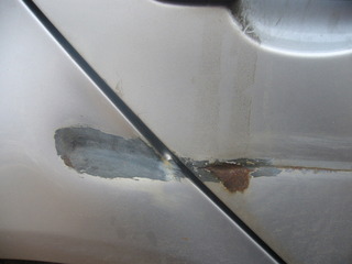

Hutchy - Your car seems more or less as new so It was a decent repair. Im just now trying to find best place to get it done. Sanded out the rust on mine today and sprayed more primer on it . Trying to stop the rot setting in before it gets sorted.
Do you think that the bumper one is easy enough to sort or is it better getting this done as well?

I'd change the door if I were you.. It's already started rusting and each time you sand it it'll just rust again because the galvanisation has been removed.. a good 2nd hand door would still be rust proof. If you get your existing door filled and painted it could rust through again.

You cant get into the rear quater as its all "double skinned" it has to have the small nails welded up and pulled out that way.

About the door possibly rusting through again , is this not the case with the dent aswell... Dont understand why if anything is cleaned, de-rusted ,primed properly and finsihed then there should be no chance of rust appearing again. Its a different story underneath , i.e stone chips abrasion etc .

If the jobs done correctly, rust wont come back through.
