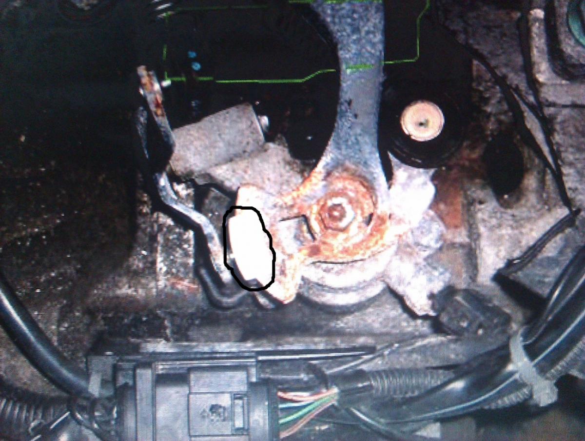

It looks like a few bushes are worn out on my linkage as my car has done may miles as a taxi before I got it. I am looking for one of these if anyone has got one (picture below the white nylon thing).
The picture is not from my car by the way.
