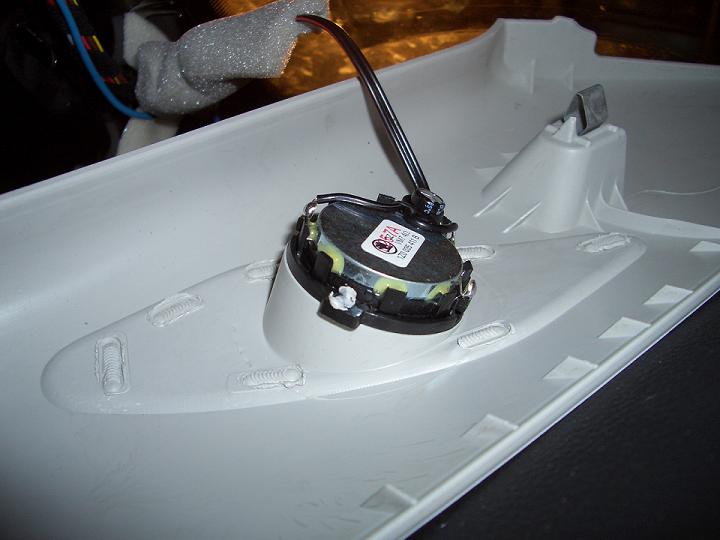

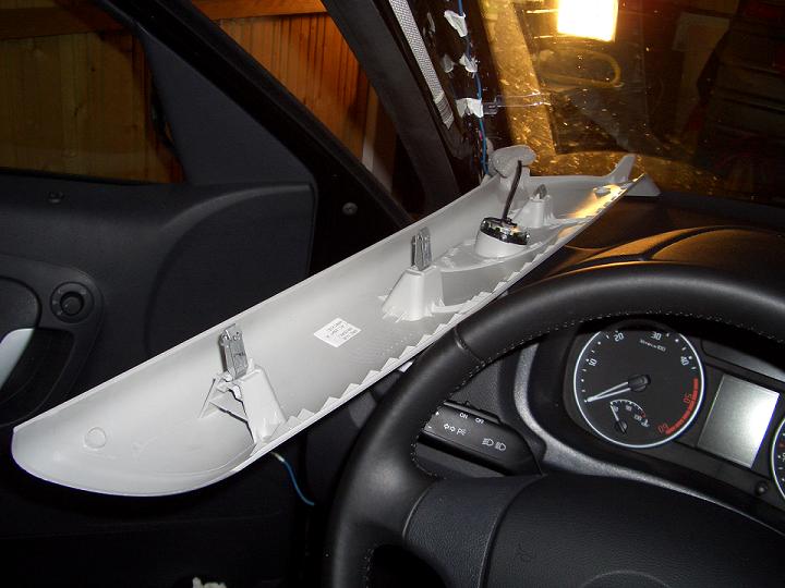

Going to attempt this tonight :) but had a quick check last night and i couldn't get the pillar housing off, i can try to prise it off at the top but it only comes out so far, i'm worried about snapping it. what area of the pillar should i attack it from? i've got a trim removing tool or should i go for the trusty screwdriver? thanks
Do you mean the inner trim of A pillar? Added some pics to see the clips. Start pulling from the top ;)
Edited by irfant
Do you mean the inner trim of A pillar? Added some pics to see the clips. Strat pulling from the top ;)
Thanks :) i'll give it a go!
